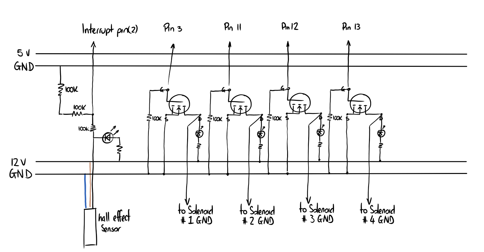

Hi all.
I'm working on a project that uses a hall effect sensor to control the timing of some 12V solenoid valves. The problem I had used LEDs to indicate the valves back in the early stages when I was working on the valve sequence, but now that I've connected up the valves they're playing havoc with the interrupt - I suspect it's interference.
I also noted that just touching the wire that runs to the interrupt pin causes massive interference with the valves...
I've attached two videos below - one showing the sequence working (sans valves), the other NOT working (with valves) - In both videos, note the yellow LED is showing when the hall effect sensor is triggered. This is when I expect the valves will move along their sequence.
Valve sequence working: Valve Sequence Working Well - YouTube
Valve sequence NOT working: Valve Sequence NOT working - YouTube
Any idea what I can do to ensure that the sequence works correctly and reliably? I've spent way too much time trying to figure this out myself...

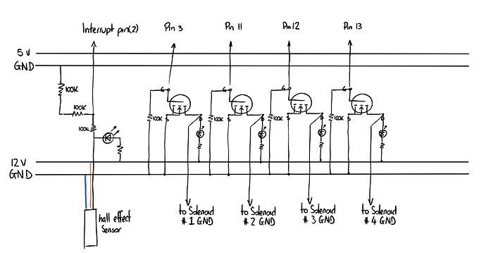

The schematic and code is also shown below.
EDIT: In the schematic below I forgot to connect the two grounds. They are in fact common grounds.

Two quick ideas:
1: You voltage divider from 12V is shown as wrong.. You need the 200K in the series lead and the 100K to ground.
2: Electromagnetic Interference from the inductance of the solenoids. See:
http://arduino-info.wikispaces.com/RelayIsolation
It looks like your 5V circuit (Arduino) does not share a Ground with your 12V circuit (MOSFETS). That will make it hard for the Arduino to switch the MOSFETS properly. Connect the two Grounds together.
terryking228:
Two quick ideas:
Thanks for that, I'll make that change to the voltage divider tonight and give it a shot. Having a read through that wiki now too...
johnwasser:
Thanks John. That's an error in my schematic. The two grounds are common, I realised that mistake a little while ago.
Are there diodes across the solenoid coils to absorb the reverse voltage spikes when the magnetic field collapses?
