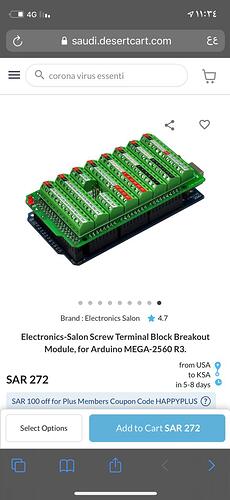

I am using this shield to connect the wires to Arduino and I think they are well sheilded by it.
The myNex.NextionListen(); has a delay in it. So your sketch can not respond quickly.
Other functions for the Nextion wait for a reply.
I'm not sure what the myNex.readNumber() is doing, it is probably up to no good as well.
Do you use the normal Serial port for the Nextion ? Please use the normal Serial port for debug messages to the Serial Monitor and use one of the others for the Nextion display.
No, not at all.
This is a properly shielded Arduino.
