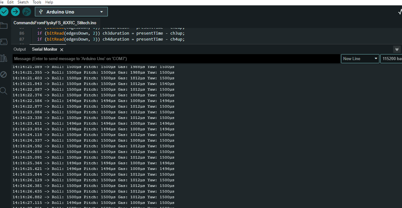

I tested your sketch (with changes: loop() emptied, internal pull-ups for buttons), and it worked fine.
I noticed that your baudrate is ridiculously low. It is possible, though not recommended, to use Serial.print in an ISR. It is not recommended because once the outputbuffer is full, the serial communication is blocking. The outputbuffer is 64 characters long. After sending 1 character only 1 character can be added and it’s blocking again for about 16 milliseconds. Compare this with the expected rate of triggering the ISR: 8 times in 20 milliseconds at minimum, when driven by your RC system.
Next problem: the message in loop() is bigger than 64 characters and will immediately affect the triggering of the ISR. At 600 baud this blockage will last more than 1 second, in this time you won’t be able to measure anything.
I suggest to make the line: Roll 1234, Pitch 1357, Gas 1432, Yaw 1987 μs (less than 64 characters) and baudrate 115200 (both in sketch and in IDE).
For the debug line in the ISR: print only 5 characters per call (4 bits and LF/CR).
I used that BAUD rate to slow down the Serial Monitor. Now, I seem to have a bigger problem. All serial prints from showFlyskyPwmLength() are zero. Would it be possible that the receiver (or transmitter??) went busted somehow??
Your board is waiting for the previous character to be sent, and won’t be able to measure anything. It’s the serial speed that is the problem.
Switched to Serial.begin(115200); and all outputs are zero.
Roll PWM Length: 0µs -> Pitch PWM Length: 0µs -> Gas PWM Length: 0µs -> Yaw PWM Length: 0µs
Roll PWM Length: 0µs -> Pitch PWM Length: 0µs -> Gas PWM Length: 0µs -> Yaw PWM Length: 0µs```
I’m testing with buttons, not a RC receiver, but I do see a measured time.
As far as I can see the program is working, even with these unnecessary long strings.
Is your RC receiver working? Best test it with servos.
Sketch is now working as well as before, but I do not understand why printing from showFlyskyPwmLength() never occurs when I have Serial.prints() in the ISR. It only prints from showFlyskyPwmLength() when I remove all serial prints from the ISR. It's like it gets stuck inside the ISR, makes no sense to me.
Serial speed.
I switched to higher baud and now I can see "some" printing from showFlyskyPwmLength(). However, most the printing is from of the ISR. In addition, the pulse durations are way off the gimbals position. When I remove all printing from the ISR, these errors disappear and the pulse durations are way more accurate.
. Any clues why all of this is happening??
Read post #72 again.
Sorry, I guess it's all there. My bad.
Much better after implementing your suggestions. What I still can't understand is why there are so many more lines printed inside the ISR than from showFlyskyPwmLength() called in loop.

Remove the prints from the ISR and see what happens if you manipulate the gimbals.
If I remove prints from ISR PWM readings behave as expected
Just for confirmation: go back to the sketch in post #1, change the serial speed to 115200 and see what happens.
I guess we spent a long time looking at the wrong places. But we did learn a lot in the mean time.
