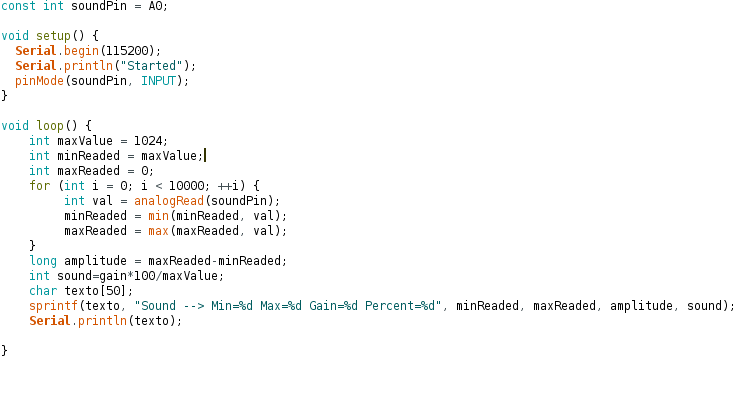

Here the code:

Delta_G:
That picture of your code is cute, but I don't have any OCR that can read it and give me back the code. Could you actually just copy and paste the code?
Sorry about that. I added the code to the post, than you :smiley:

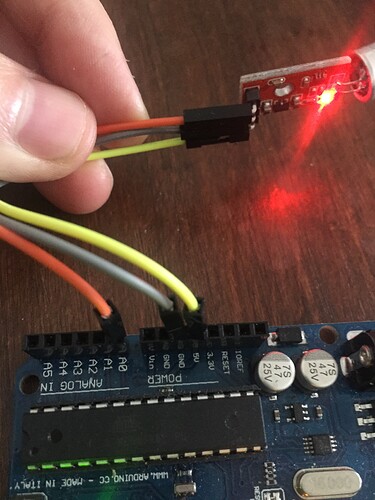

The wiring is the following:
  • Sensor VCC to Arduino 3.3v
  • Sensor GND to Arduino GND
  • Sensor OUT to Voltage Divider
  • Voltage Divider R2 to Arduino GND
  • Voltage Divider Between 2 Resistors to Analog Arduino
The sensor works with 3.3-5v and the output is 0-3.3v.

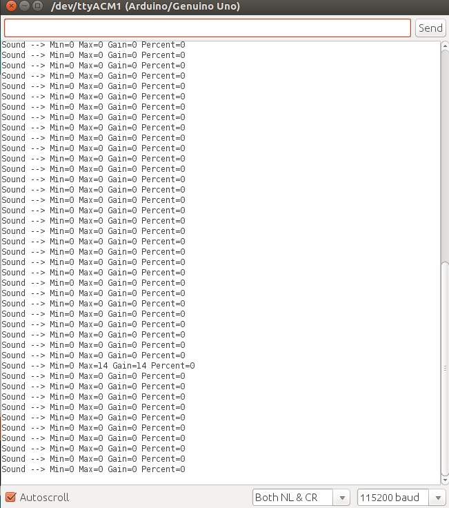

With this multimeter and with divider, i read 0V
With this multimeter and without divider, i read 0V-0.6V (but I guess it's not reliable)
It's very strange, I can not think what else to try.
I connect the microphone output to the analog input of the Arduino and it gives me values close to 300 in silence.
I disconnect the microphone output from the Arduino and connect it to the voltage divider (and this to the Arduino), and I read 0 in silence! (not 150)
It works perfect with a constant voltage, such as a battery. With a battery of 5v with this voltage divider i read 512 (2.5v).
There is a possibility that it does not work with voltage waves as in this case?
