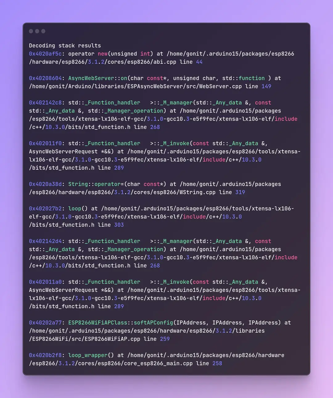

Sorry can’t read this image of text on my iPhone - it’s too small
Post text as text
Here's the picture I made clear
please, please never ever again post pictures of text... Not only they are not readable nor usable directly for copy&paste but they use up lots of storage and internet bandwidth which contributes to polluting the planet.
I won't try to read it sorry. I'm out.
OK, I'll send the text
Decoding stack results
0x4020af5c: operator new (unsigned int) at /home/gonit/.arduino15/packages/esp8266 /hardware/esp8266/3.1.2/cores/esp8266/abi.cpp line 44
8x40208604: AsyncWebServer::on (char const*, unsigned char, std::function) at
/home/gonit/Arduino/libraries/ESPAsyncWebServer/src/WebServer.cpp line 149
0x40214208: std::_Function_handler >::_M_manager(std::_Any_data &, const std::_Any_data &, std::_Manager_operation) at /home/gonit/.arduino15/packages /esp8266/tools/xtensa-lx106-elf-gcc/3.1.0-gcc10.3-e5f9fec/xtensa-1x106-elf/include /c++/10.3.0/bits/std_function.h line 268
8x402011f8: std:: Function_handler >::_M_invoke(const std::_Any_data &, AsyncWebServerRequest *&&) at /home/gonit/.arduino15/packages/esp8266/tools/xtensa- 1x106-elf-gcc/3.1.0-gcc10.3-e5f9fec/xtensa-1x106-elf/include/c++/18.3.0 /bits/std_function.h line 289
0x4020a38d: String::operator= (char const*) at /home/gonit/. arduino15/packages /esp8266/hardware/esp8266/3.1.2/cores/esp8266/WString.cpp line 319
8x482027b2: Loop() at /home/gonit/.arduino15/packages/esp8266/tools/xtensa-lx106- elf-gcc/3.1.0-gcc10.3-e5f9fec/xtensa-lx106-elf/include/c++/10.3.0 /bits/std_function.h line 303
0x402142d4: std:: Function_handler >::_M_manager(std::_Any_data &, const std::_Any_data &, std::_Manager_operation) at /home/gonit/.arduino15/packages /esp8266/tools/xtensa-lx106-elf-gcc/3.1.0-gcc10.3-e5f9fec/xtensa-lx106-elf/include /c++/10.3.0/bits/std_function.h line 268
0x402011a0: std::_Function_handler >::_M_invoke(const std::_Any_data &, AsyncWebServerRequest *&&) at /home/gonit/.arduino15/packages/esp8266/tools/xtensa- 1x106-elf-gcc/3.1.0-gcc10.3-e5f9fec/xtensa-lx106-elf/include/c++/10.3.0 /bits/std_function.h line 289
8x40202a77: ESP8266WiFiAPClass::softAPConfig(IPAddress, IPAddress, IPAddress) at /home/gonit/.arduino15/packages/esp8266/hardware/esp8266/3.1.2/libraries /ESP8266WiFi/src/ESP8266WiFiAP.cpp line 259
8x4820b2f8: Loop_wrapper() at /home/gonit/.arduino15/packages/esp8266/hardware /esp8266/3.1.2/cores/esp8266/core_esp8266_main.cpp line 258
I've sent the text
