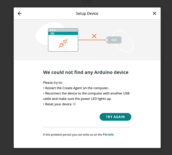

Sorry in advance for a long message. I wanted to include as much information as possible about this issue.
I recently got an Arduino Nano RP2040 Connect with the intention of using it for an IoT Cloud project. When I try to add it as a device, I encounter an issue while the web editor is configuring the board for cloud use. I have tried the process on four different devices. This is what happened...
Two windows machines:
I select setup arduino board, install the arduino cloud agent, and plug in the board. It is recognized by the web program and starts configuring. I name the board and it tries to upload a sketch, but the program then says that no board is found after thinking for a minute.
I am able to upload a standard blink sketch to the board from the desktop version of Arduino IDE, but not from the web version.

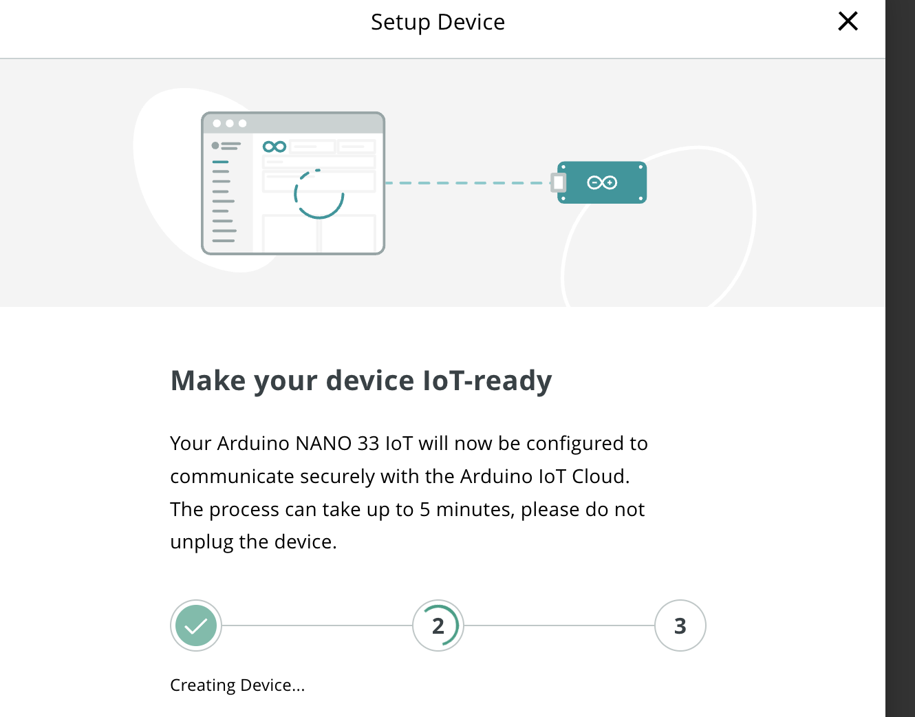

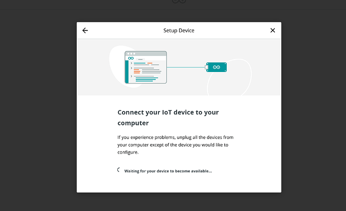

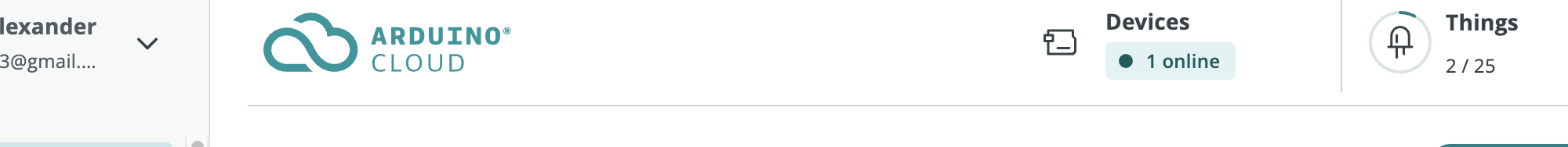

Sorry, I am not understanding what is going on. Let me show some screen prints of normal operation then you can show us your screen if it is different. I will use a different board but that is not relevant.

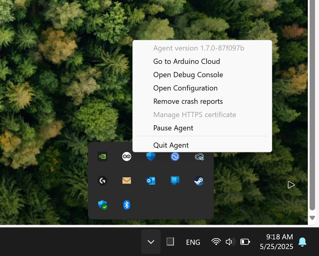

BTW, thge Cloud Agent should already be running, it starts when you power on your computer and never shuts off.
After login in to the cloud
Click on Device

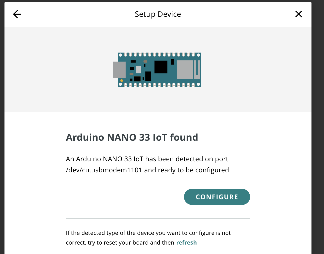

Click on Arduino Board
Click Configure
Wait for it to setup the board, can take 5mins
FOLLOW instructions, remove USB, plug USB back in
Press Continue

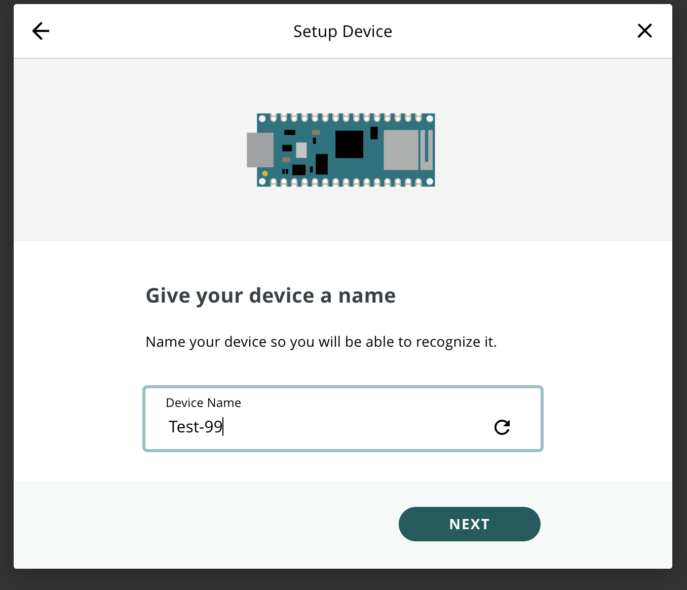

Name the board
Wait up to 5 minutes for board to be made IoT ready

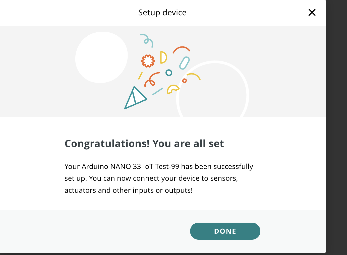

And we are done
Press Done and this is the final screen

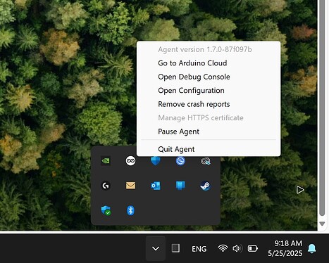

Here are some screenshots:
Cloud Agent is running

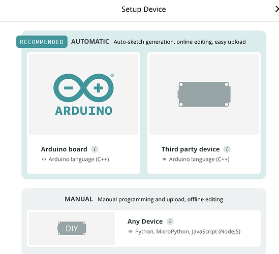

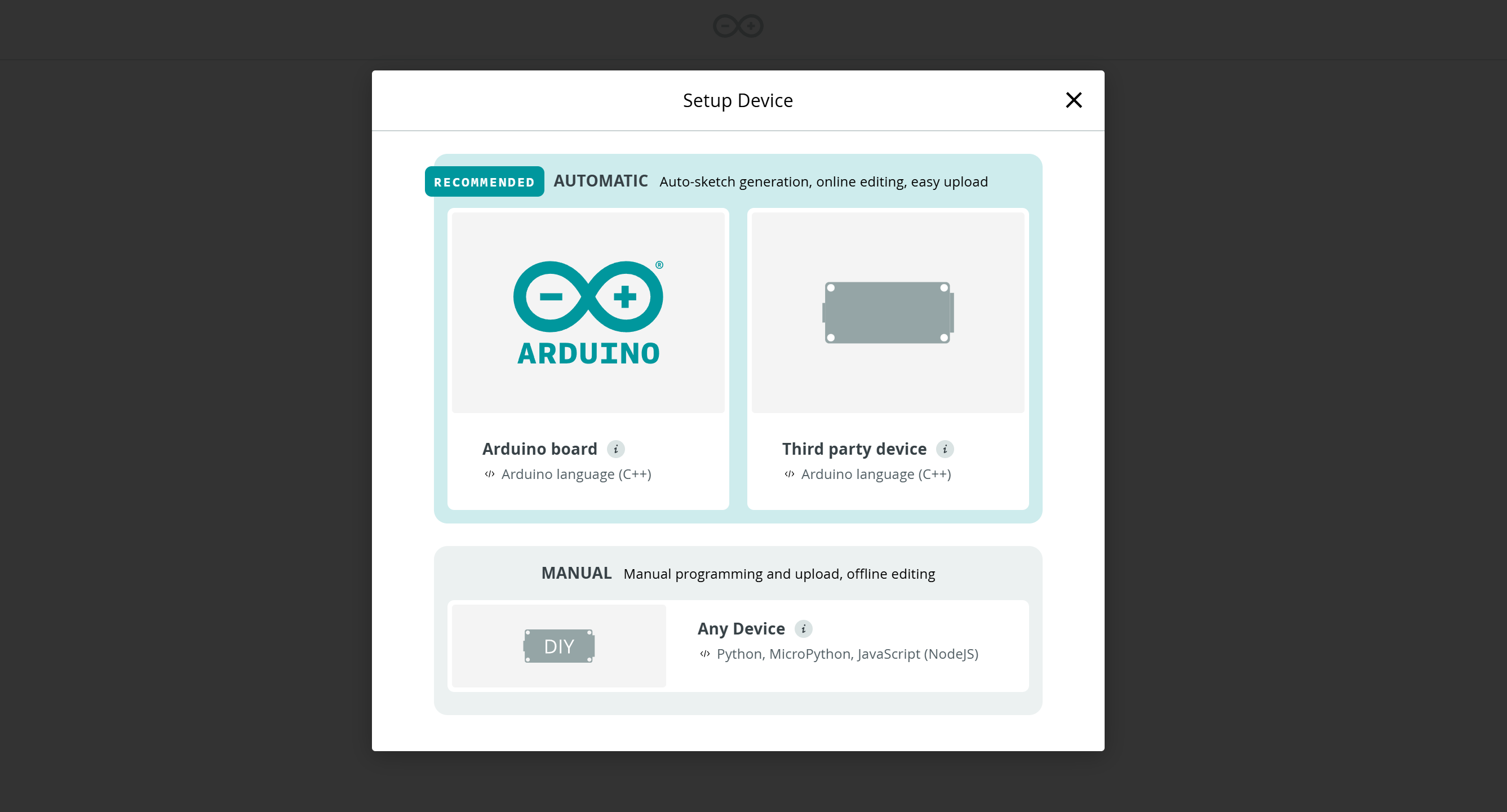

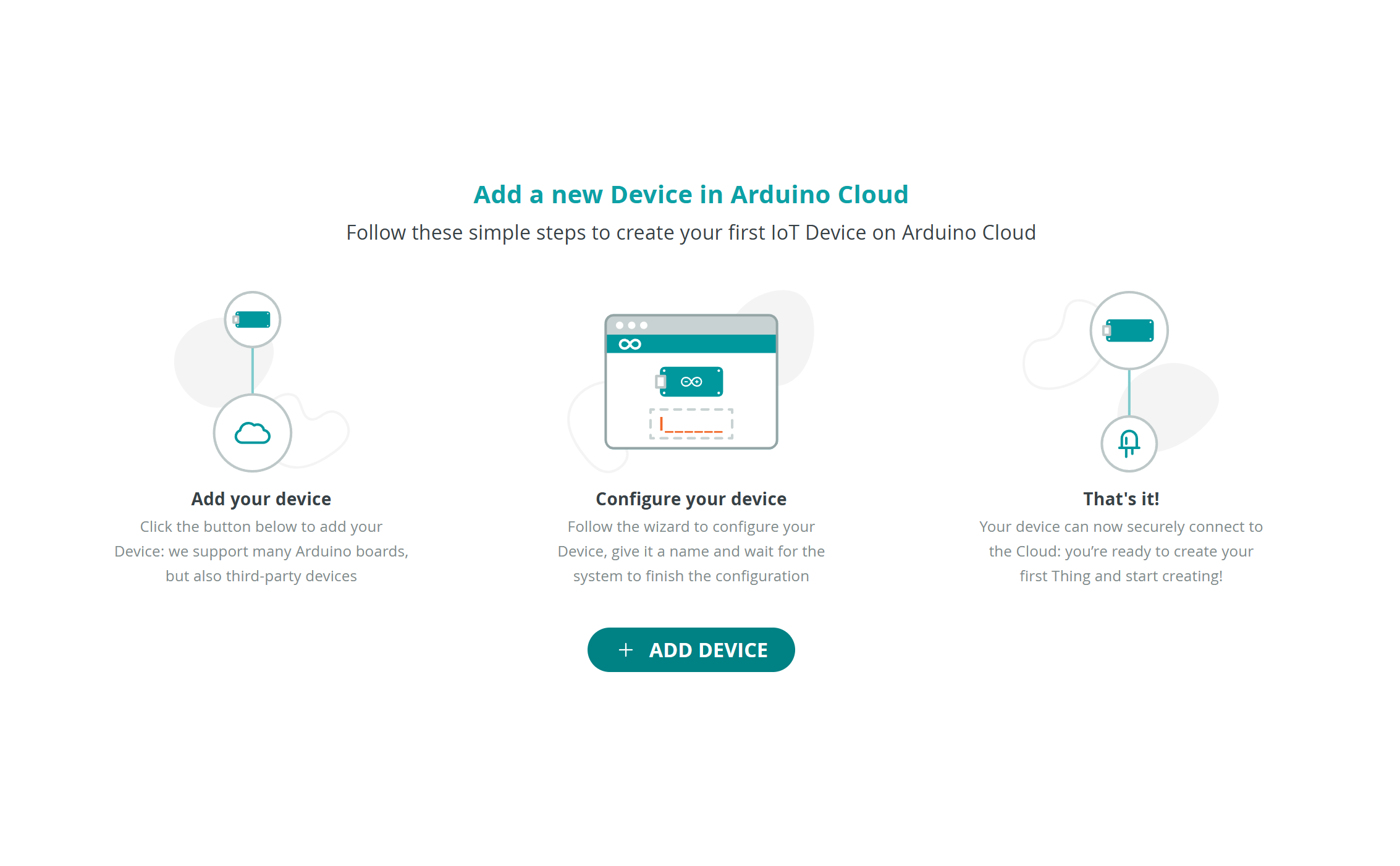

I click "Add Device"
Select Arduino Board
Next this screen opens

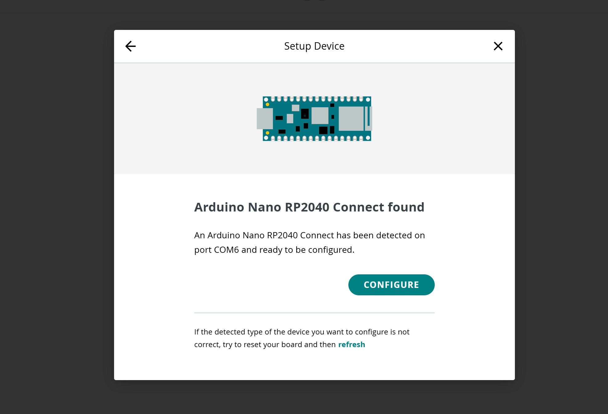

I plug the Nano RP2040 in and this appears after a few seconds

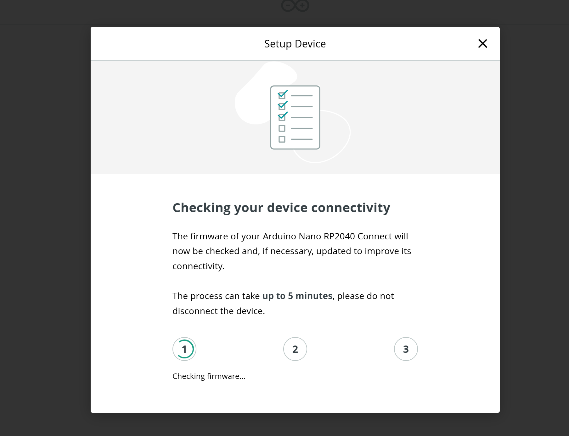

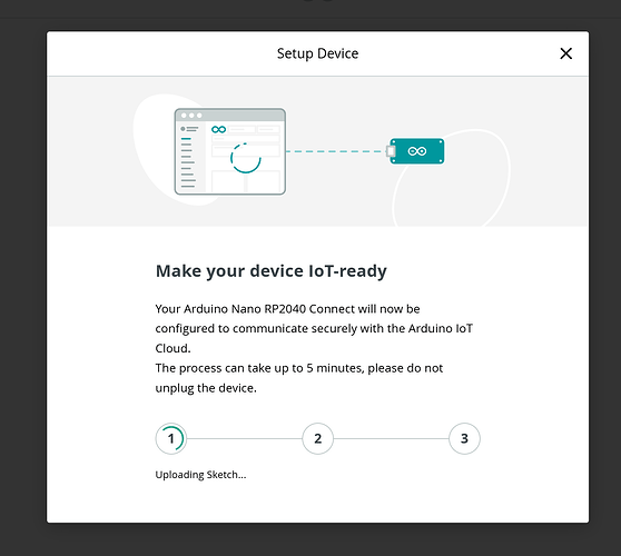

I click "Configure" and it shows this screen. During this time the nano reboots and the RPI-RP2 drive appears on my file explorer.

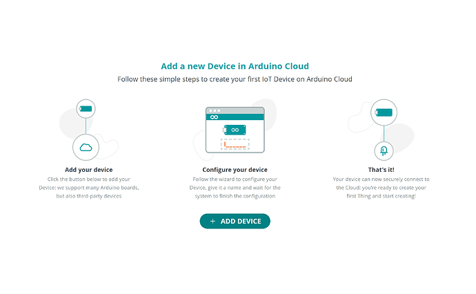

I then am prompted to name the board
After naming, it returns to this screen
After a few seconds, I see this

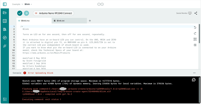

If I try to upload a regular sketch from the Cloud IDE, I receive this error:

Sketch uses 60060 bytes (0%) of program storage space. Maximum is 16773120 bytes.
Global variables use 9552 bytes (3%) of dynamic memory, leaving 252592 bytes for local variables. Maximum is 262144 bytes.
"C:\Users\richt\AppData\Local\Arduino15\packages\rp2040\tools\pqt-python3\1.0.1-base-3a57aed-1/python3" -I "C:\Users\richt\AppData\Local\Arduino15\packages\rp2040\hardware\rp2040\4.5.3/tools/uf2conv.py" --serial "COM7" --family RP2040 --deploy "C:\Users\richt\AppData\Local\arduino\sketches\D2FF026FC8C8500E769F80AF89492921/Blink.ino.uf2"
Resetting COM7
Converting to uf2, output size: 153600, start address: 0x2000
Scanning for RP2040 devices
Flashing D: (RPI-RP2)
Wrote 153600 bytes to D:/NEW.UF2
That is the output I receive with these preferences (on the desktop IDE):
