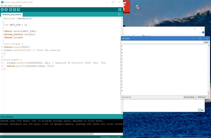

So anyway, I am having a hard time trying to send ir code from LED to the receiver.
When using small remote that came with it, I can read values in HEX no problem.
But when I try to send a value from the LED it always shows the value at 0 and nothing happens.
Sure the receiver is wired right as it reads the remote HEX.
The problem must be in the LED emitter.
I have it connected - to ground in Arduino and + to output 4 (tried 5 with same result).
There is an 330kOhm resistor on the + of the LED.
Screenshot of code and serial window are attached.
I'm new to Arduino so please understand and forgive me if it's a simple mistake :slight_smile:

330K is way too much for a LED.
Try 220 ohm.
Make sure you have the cathode of the LED going to GND.

I put 220Ohm resistor instead, and changed the code.
#include <IRremote.h>
int IR_PIN = 4;
IRrecv irDetect(IR_PIN);
decode_results irIn;
IRsend irsend;
  irDetect.enableIRIn(); // Start the Receiver
    sendSony();
  if (irDetect.decode(&irIn)) {
    decodeIR();
    irDetect.resume();
void sendSony() { for (int i = 0; i < 3; i++) {
    irsend.sendSony(0x640C, 15); //Sony vol-
    delay(40);
    decodeIR();
    irDetect.resume();
  delay(2000);
void decodeIR() // Indicate what key is pressed
  Serial.println(irIn.value);
Its very strange as sending works on my Sony home cinema but its still showing 0.
I think that line always reads 0 for some reason:
But I have the same line in a separate receive program and it reads proper HEX.
Would be nice to figure it out but at least it works now.
