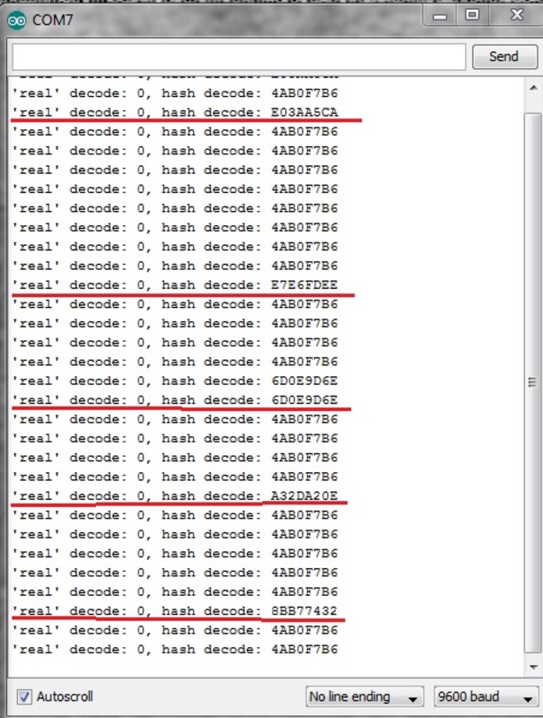

If the IRRemote library doesn't recognize the encoding scheme it will provide only the raw pulse times. Here is an article about using unknown remotes:
I tried it , but the result is interesting for me :
I recived different values but I pressed only ONE button. That means what ?
And when I use different remote control I received first value diferent but when I keep button pressed I receive the same value for rest of value :
Some remotes send the same code repeatedly. Some send a "repeat" code to indicate that the same button is held down. You write your code to do what you want with the information you get.
