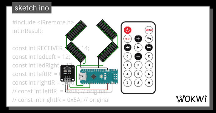

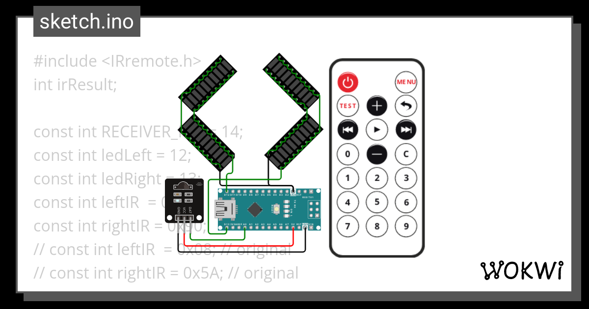

> [@bert\_d](#):
> I just tried the code,
I probably made mistakes and wrote values double, or backwards (to adapt my IR code to your IR code). Here is a simulation... Press \<\< or \>\> and then any other key turns blinking OFF.
> **[directionalIndicator - Wokwi ESP32, STM32, Arduino Simulator](https://wokwi.com/projects/385477811046574081)**
> Run IoT and embedded projects in your browser: ESP32, STM32, Arduino, Pi Pico, and more. No installation required!

great, see it working in your very nice simulation, guess I should be able to get it working too

It works fine now!!!!
Had to change one line:
// if (irResult == 0xE0 || irResult == 0x90) {
into
if (irResult == 0x8 || irResult == 0x5A) {
Thanks a lot for the help, have to implement it now in the other sketch.
