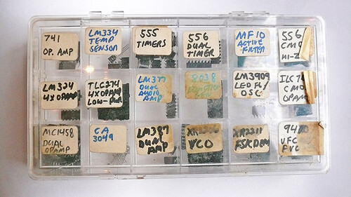

Wow, I remember paying about $12 for a 741 / 748 when the Philbrick Researches discrete-transistor boxes were $55.
As you can see, it's first in my box labelled "Linear ICs" |500x281
Here are 3 different ones in there: |281x500
One is National Semiconductor, I think. And one has a 1973 date code.
The silk-screen labeling wasn't too good back then. Today that would be evidence of a counterfeit. The dust on my box tells me they are genuine.
