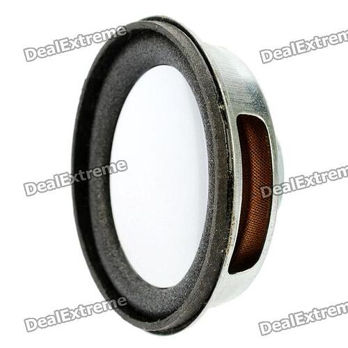

Greetings CrossRoads,
Thanks so much for your help. Do you suppose the IRF3710 is an acceptable replacement for the IRF3707Z?
What does the sensitivity rating for a speaker refer to?
Thanks again,
Peter.
Which IRF3710?
Maybe, maybe not. 3710 are not really spec'ed as logic level devices, the 3707 was selected because it had good numbers at Vgs of 4.5V.
Sensitivity – The sound pressure level produced by a loudspeaker in a non-reverberant environment, often specified in dB and measured at 1 meter with an input of 1 watt (2.83 rms volts into 8 ?), typically at one or more specified frequencies. Manufacturers often use this rating in marketing material.
So generally, higher sensitivity = louder sound. Those little mpja speakers work quite well. I havre 6 scoring machines, my wife is always telling me they are too loud. I think they sound great - programmed to make a 2-tone warble kind of like a cell phone, using 2 notes from the Tone library. Not all the same, makes an interestint racket when all 6 are powered up at once from the same power strip.
But what you've shown in the schematic is a Class B amplifier with a seriously large threshold. It'll take much higher than line levels to get a meaningful output, and it will be highly distorted.
You can run an LM386 with a heat sink, use a 4 ohm speaker like the one suggested, and run the LM386 with the gain setting capacitor added and from higher voltage. That will likely get you loud enough. You have the parts, try it.
A reasonable way to tell speaker sensitivity is magnet size. Larger magnet, higher efficiency, louder speaker.
