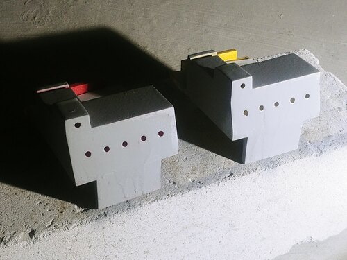

Hi everybody! The problem with the shift register is resolved, everything works fine now. Take a look at the progress:
I'm still waiting for the motor driver. . .. . ahhhh damn Ever Given :smiley:
