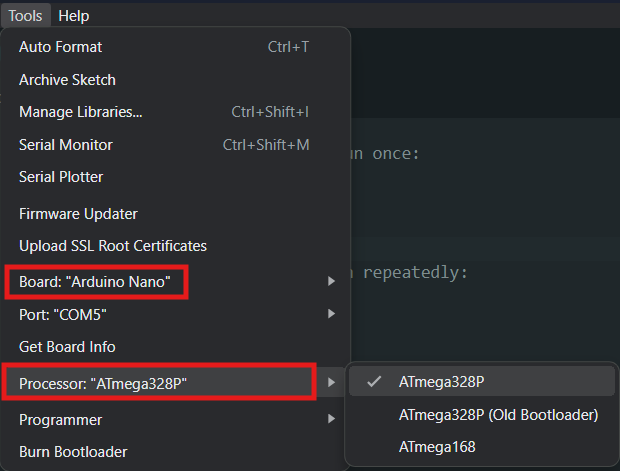

Hi, I am using a sketch that loads on an Uno but not a Nano. I have not encountered this before. The message reads
"avrdude: stk500_recv(): programmer is not responding
avrdude: stk500_getsync() attempt 1 of 10: not in sync: resp=0x6e
I am no expert but cannot see anything in the sketch that may be causing this.

The Nano comes in a few flavours. You have a choice under tools / processor between 328P, 328P (old boot loader) and 168.

What I did was to disconnect all the pins to the Nano and it loaded. I then reattached the pins. I have had to do this on many projects before and not sure why I did not think to do it this time.
In essence he was correct. What works on an Uno works on a Nano, I guess.
You had something connected to pin 0 or pin 1? Or the RST pin?
