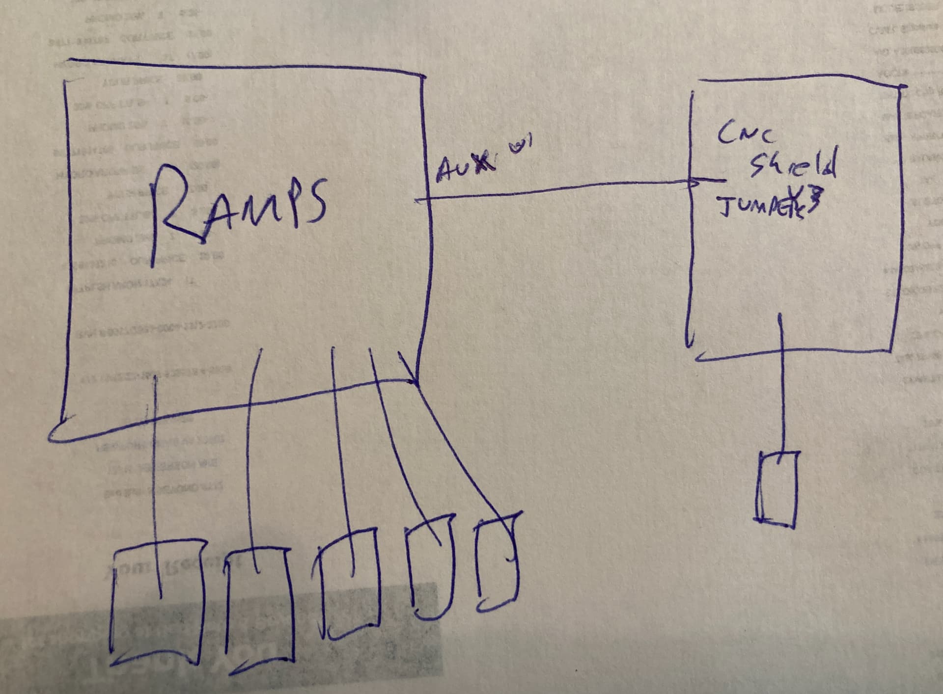

Hey, I'm a student working on a research paper that involves using 6 stepper motors for 6 axes. So far, the CNC Shield only supports 3 axes, while the RAMPS supports 5 axes. Is it possible to create a schematic for 6 axes and could anyone help me find a good adapter that allows me to use 2 CNC shields with a MEGA 2560?

RAMPS boards have auxilary headers, and you can wire a couple of those pins up to another driver.

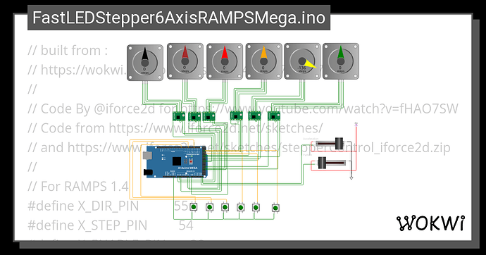

Here's a few simulations of 6 axes on a RAMPS:
I mean that you can combine a RAMPS with a (genuine or clone) Protoneer CNC Shield V3 with some jumpers from the RAMPS board to the Protoneer:
You could then drive maybe 9 steppers from the assembly.
Or with a Giga and multiple CNC V3s you could drive 8, 12, 16+ steppers.
