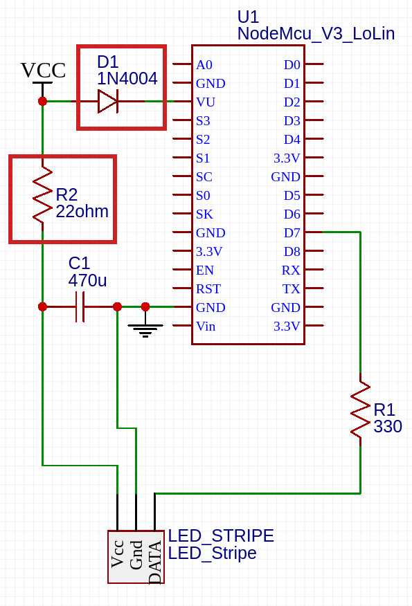

Is it possible to use 1N4004 rectifier diode to drop forward voltage?
Hi, In previous thread I was figuring out why my leds wouldn't light up or act weird and saw that my esp8266 controller does not like the power I was providing to it (~5.2V). Then I started looking into a way to drop voltage by a bit to keep it under 5V.
Yesterday I saw some advice on internet to use diode to drop voltage by 0.7. So to this schematics:
I added 1N4004 diode(and later when it worked not as expected, I also added a pull up resistor(because I saw in some example on internet, but I think I misunderstood that example)
I am missing some knowledge of how diode/electricity works, cause the result I got was:
When I added only diode:
Controller was powered with 4.8V, but LED strip was having 1.3V.
When I additionally added 22ohm pullup resistor, led stripe voltage increased to 1.7 and controller voltage dropped to around 4.3V.
Am I doing something crazy here? Would that change things if I'd use schottky diode instead?
Should the schematics be revired in some other way?
Any other approach you could recommend?
given that I'd like to stick with this power supply and voltage dividers I saw usually require higher input voltage
Thanks

I am using MeanWell 5v source(actual output 5.2V) to power both esp8266 and ws2812b(see 1st pic). I was having weird behavior. LED's lighting up and freezing after working couple of seconds or glitching, etc.
Eventually what I did:
Connected a lab power supply, started with 4.9V and gradually increased voltage, when it got to 5.2 LED's started glitching again.
Dropped down to 4.9 - was working just fine again.
So I figured it's a controller that does not like 5.2V.
One mistake that people pointed me out in this forum was that I was feeding it to VIN, because it uses volt divider. Now I am using VU to power up arduino.

With diode, without 22ohm resistor here are the readings:
gnd and Vcc AT the LED STRIP connector: 1.3V
gnd to VU: ~4.8V
gnd to cathode: 5.2V
When I disconnect controller, then voltage at gnd and Vcc at led strip becomes 5.2V.
So something starts happening with the voltage at led strips once current starts flowing to VU.
I did double check wiring couple of times.
Can you post some pictures of your project so we can see your component layout please?
The cathode of D1 and VU should be the same, look at your circuit diagram.
The cathode of the 1N4001 is the end with the strip around it.
Vcc at the Strip connector should be the same as Vcc, look at your circuit diagram.

Sorry, I must have checked some wrong google image pic. Thought by cathode you meant anode.
Cathode is at the same voltage as VU: ~4.8. Anode(before current gets to diode) is at 5.2.

The problem is not the ESP getting 4,9 or 5,2V, but it's the strip. It's threshold of a logical 0 or a logical 1 depends on the supply voltage. And the strip just isn't designed to get 3,3V data. So you're just balancing between a 0 and a 1 even when supplied with 3,3V.
Simple level shifter. I expect that to work fine even with the high data rate of the Neopixels.
I am missing something here. In which part of my schematics I am providing 3.3V?
Cause I am trying to feed ESP with 5V and I am feeding led strips with 5V.
Do you mean that data line then provides 3.3V to the strip?

First post, right from D7. An ESP is a 3V3 device. When powered from 5V all the board does is drop that to 3V3 for the ESP. Digital outputs are still 3V3!
And, although a lot of peoples suggest an ESP is 5V tolerant, officially it's not and you should not provide more then 3V3 on an input either.

The power input to the board does not need (and must not have) voltage divider. The board has a regulator powered by Vin and outputting the 3.3 to power the chip. Never use voltage divider to supply power, only for data lines.
Voltage divider is generally necessary if interfacing output of 5v to an i/o pin of 3.3v chip. But the esp8266 is 5v tolerant; manufacturer has said as much, albeit not in the excuse for a datasheet, and hobbyists have confirmed this experimentally.
You do need to either levelshift voltage of data line for the leds up, or power leds with 5.0 volts - as noted above, the threshold for determining whether the data line is a 1 or 0 is based on the voltage supplied to the led strip, while the data line is always 3.3v logic levels. Level shifting is probably better.
Note that you do not need any exotic "level shifter", and especially not one that contains resistors!
A 74HCT14 with two gates in series is perfect (and you have four other gates spare), a 74HC14 will likely work as well. :grinning:

The "HCT" means that it will work at 5 V supply with a 3.3 V logic input. Any IC so marked will do so by definition; there is nothing special about that particular one. :grinning:
in the end logic level shifter is what did the trick. Added SN74AHCT125N, removed added diode/resistor and now thing is working with 5.2V flawlessly. Thank you all for the input
