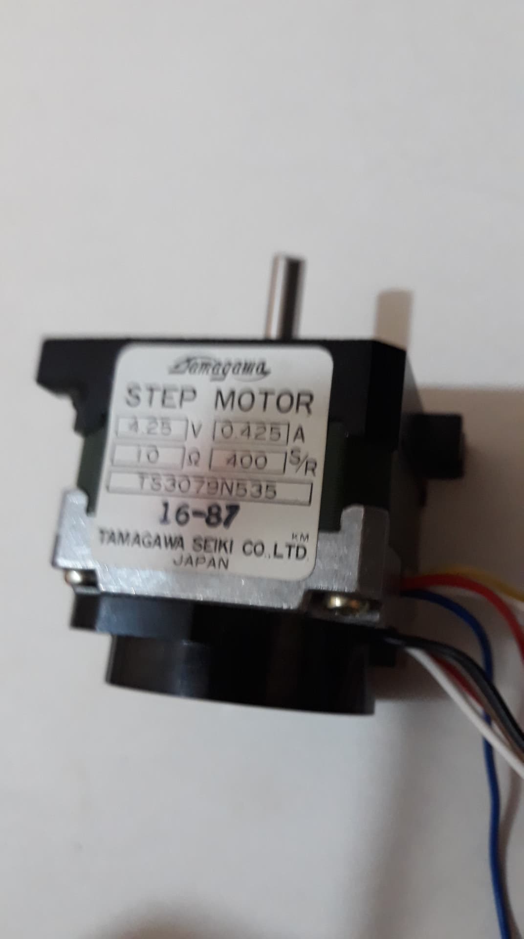

This is the motor

But what about the impedance! is 10 ohm considered a high impedance or low!
probably low! so I can't use the L298N for this motor ?
10 Ohms is intermediate.
The L298 could work under certain circumstances, for example with two 10 Ohm windings in series for 20 Ohms total (left schematic in reply #4), and a motor power supply of 12V.
Taking into account a ~2V drop in the L298, the winding current would then be (12 - 2)/20 = 0.5 A, which would be a bit high for that motor.
OPs pic;
If you look at the motor it could be a standard stepper, 4 wire, with what appears to be an encoder on the end of it.
Have you got a DMM to measure some resistances?
