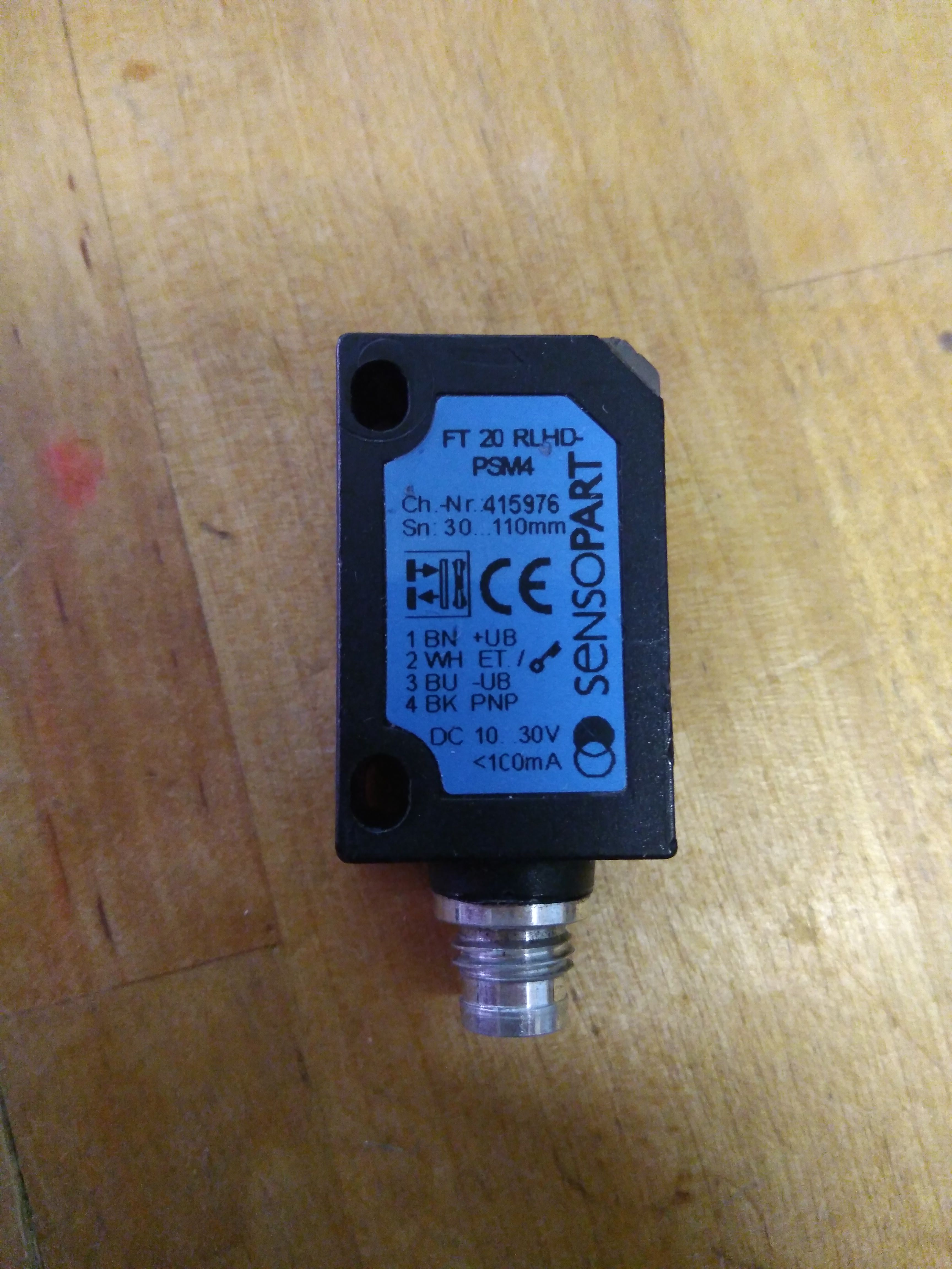

is it possible to use these sensors?
i have few sensors and dont know if i can and how to use them... all sensors are 12+volt (12-36v)
if someone have some ideas please share... (btw i dont know to code much :smiley: )

Arduino is either 5v or 3.3v. This means that something will need to be between it and the 12-30v device.

the biggest problem is those sensors are all 12+v and i tried some sensors and when they open they send 12v to data.. i dont want to destroy arduino like that :smiley:
So you use a voltage divider circuit to cut down the 12V to 5V.

If I lower the voltage, the current goes up, but the wenglor sensor (at least the one I have) works with 200mA, won't this be an issue for the arduino as well if we use a voltage divider?
No, ohms law says it dosn't.
Don't confuse the input current with the output signal.
No.
Post a schematic of what you propose just to be on the safe side.
The last device, the displacement sensor can be powered and operated of the controller supply level.
Because ALL the others have PNP switched open collector/drain you will need a potential divider.

The first one has an "Open Drain" output. That means you can connect it directly to an INPUT_PULLUP pin and the pin will go LOW when the sensor is activated. That is also true for "Open Collector" outputs, sometimes called "NPN" outputs.
johnwasser:
The first one is Open-Drain in PNP type or more correctly P-CH config.
