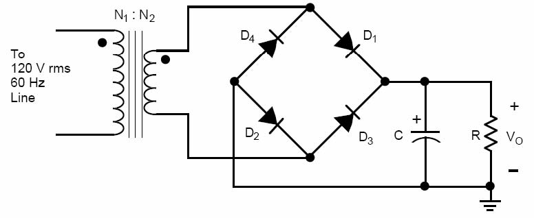

Define ground.
Earth ground or Common?
Do you consider this circuit has a ground?
It does not.
It does not.
Don't bury the OP with semantics. We have all used "ground" with "common" interchangeably. The only time it is significant is when you are dealing with mains power which has a neutral and earth ground.
Ironically, the circuit only shows an earth ground.
