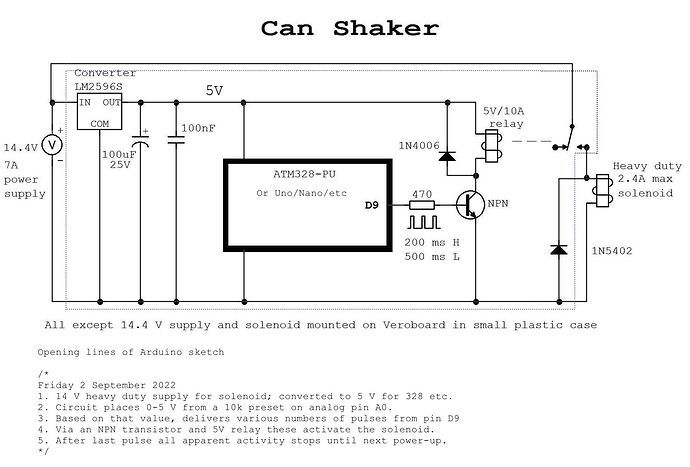

This simple project I built using a heavy duty solenoid may help. If I was designing it today I'd consider a MOSFET - although I still have rather a lot of old relays at hand.
Come back if you need help with the sketch - although perhaps in a different forum category by then so...
