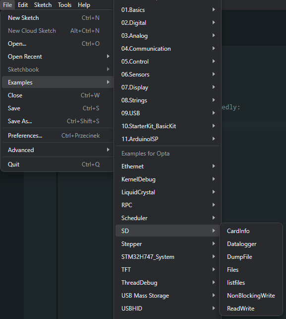

Check out this tutorial, it shows how to use memory stick. I've done it and it works, Somewhere inside program there is line of code that you have to comment (USB stick) and uncomment (SD card), but I might be wrong because i've used a few methods recently.
What I discovered is this method of data logging is unfortunately slow and not efficient, but for simple programs it can work.
Also you have ready examples of SD usage from Opta library in Arduino IDE:
