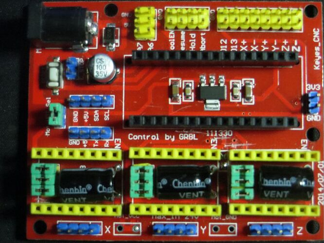

New! A4988 3D Printer Stepper Motor Driver CNC Shield V4 for Arduino. here I purchased the above shield to use with a nano and 3 A4988's. After many fruitless attempts to move from a blob board to the shield I took a carefull look at the tracks on the board. The d2,d3 and d4 tracks from the nano go to the x,y and z direction pins of the A4988's. The d5,d6 and d7 tracks go to the x,y and z step pins of the A4988's. Surely this is the wrong way round. gcode uses d2 as a step and d5 as a direction. see this. My problem is Am I the first to see this? How is everyone else getting the units working? or aren't they? Am I incorrect somehow? I have cut the tracks and soldered wires so they are correct to my reckoning. Now the direction does not alter on either of my A4988's, have I blown that part do you think?

I have a similar cheap Chinese board, being prepared for GRBL. Mine has been working out of the box, so my respected Chinese source copied and interpreted the schematics correctly.
I agree with you rather altering / rewiring the tracks than modifying GRBL, as with the next GRBL update you have to do it again. Once fixed on the hardware side and you are set.

I just ordered the same board, I have seen comments left by reviewers that referred to a change which had to be made to GRBL config to get it to work properly. I assume this is that change. I agree a hardware solution would be better than a software one. Thanks for letting me know where to look.
|500x453
  1. it "step" and "dir" is different. so, you must be change pin define. please in source code folder , looking for cpu_map.h (grbl 1.1f) (grbl 0.9J : grbl-master\grbl\cpu_map\cpu_map_atmega328p.h)
define X_STEP_BIT 5 // Uno Digital Pin 2
define Y_STEP_BIT 6 // Uno Digital Pin 3
define Z_STEP_BIT 7 // Uno Digital Pin 4
define X_DIRECTION_BIT 2 // Uno Digital Pin 5
define Y_DIRECTION_BIT 3 // Uno Digital Pin 6
define Z_DIRECTION_BIT 4 // Uno Digital Pin 7
  1. about MS1 MS2 MS3 jumper ,the circuit is wrong, you can remove jumper first,You do not need it anymore,Trust me.
  2. try to short circuit (green line)
grbl 0.9j download
good luck to you!

His schematic is not correct. You have to cut all connections between the 3 connected Jumper pins and Ground on both sides of the jumper pins and at both sides of the board and rewire all the ground together. Then connect the 3 connected Jumper pins to 5V.

I connected the 5v pin to the M0, M1 and M2, the Micro Stepping Mode of DRV8825 driver board as shown in the above picture. The AM1117 (5V reg on Arduino Nano board) was burnt as soon as I switched ON the power to Nano CNC Shield. :(
Looks like we need to add pull up/series resistors (10K) instead of directly connecting Mode pins to 5V supply.
Also another point to note here is, if Mode pins of DRV8825 are pulled high,it will be programmed to provide 1/32 resolution and for A4988's it would be 1/16 steps.
The idea given here looks to be good as we can still program micro stepping using jumper instead of hard coding it 1/32 steps resolution.
Thought to share if its useful for someone.
Regards, Guru

This board design is totally fu**ed up, there are exchanged STEP - DIR pins, but most problem that jumpers for A4988 are made for GND instead of Vcc (5V) . So to fix STEP DIR simply compile GRBL with proper pins defined or modify the board by some traces cuts and some shortcuts. Most important is to modify jumpers by adding pull-up resistors about 4k7 for proper set of micro stepping of motor, elsewhere the motor will loose steps in full step mode, or be working very slowly.
