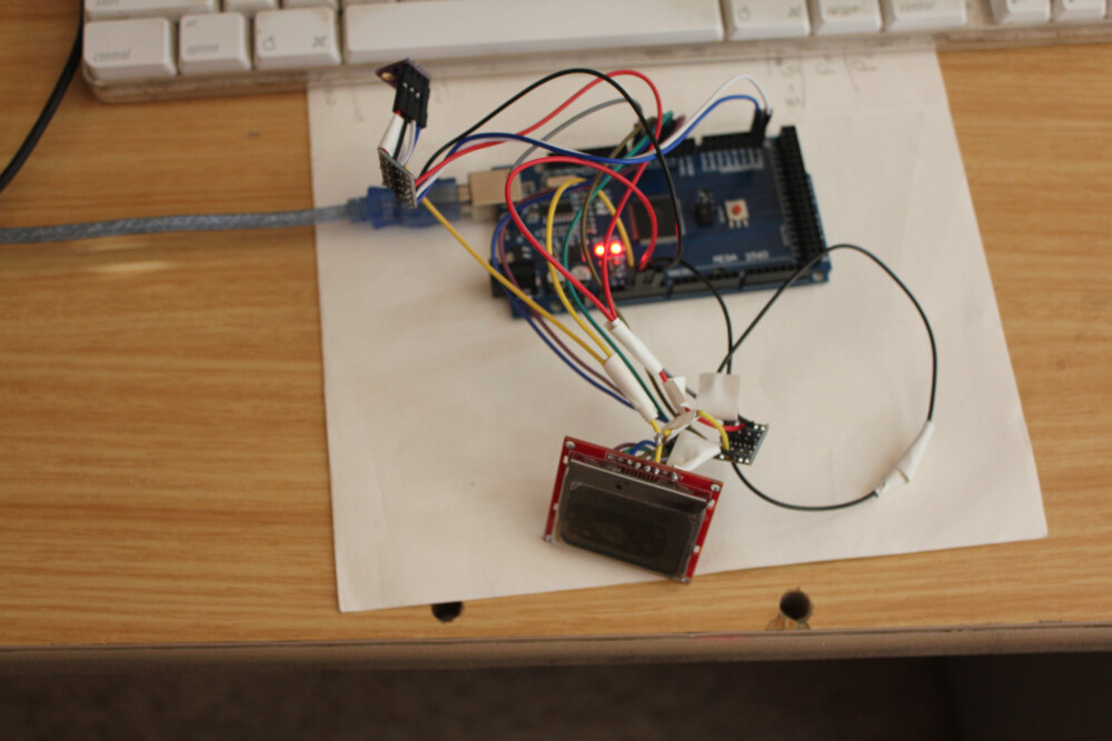

I am well pleased my first project is working.
Thanks to the tutorial on simple-circuit.com.
A bit of a learning curve but I have managed with the help of this forum to get the very basics going.
Thanks again sterretje
PS: Added pictures.
It looks a bit hairy but It works.
