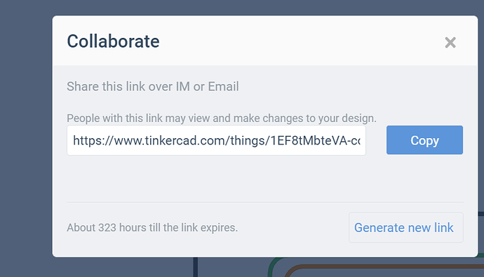

i found i could do something on Tinkercad i dunno if you guys use it.. and it has a share i dunno if it works for you guys.. i played with it i cant find how to set the Servos to 0 when the power is off it goes 0 but when powered it off sets the servo cant keep it at 0 even with negative values... if u guys can see it.. i also added 18 volts to simulate 12 volts and googled the voltage regulator
but you mentioned people in here would know how to make it more adjustable the servo for the choke.. what would i have to ask... but so far i got this part working semi
if you can see it i dunno

thats weird... it says 323 Hours left so cant be expired guesss they are glitched
so ill check that link out now then..
and i did download the arduino ide software i will install it now too
hope it all works the pics and code
