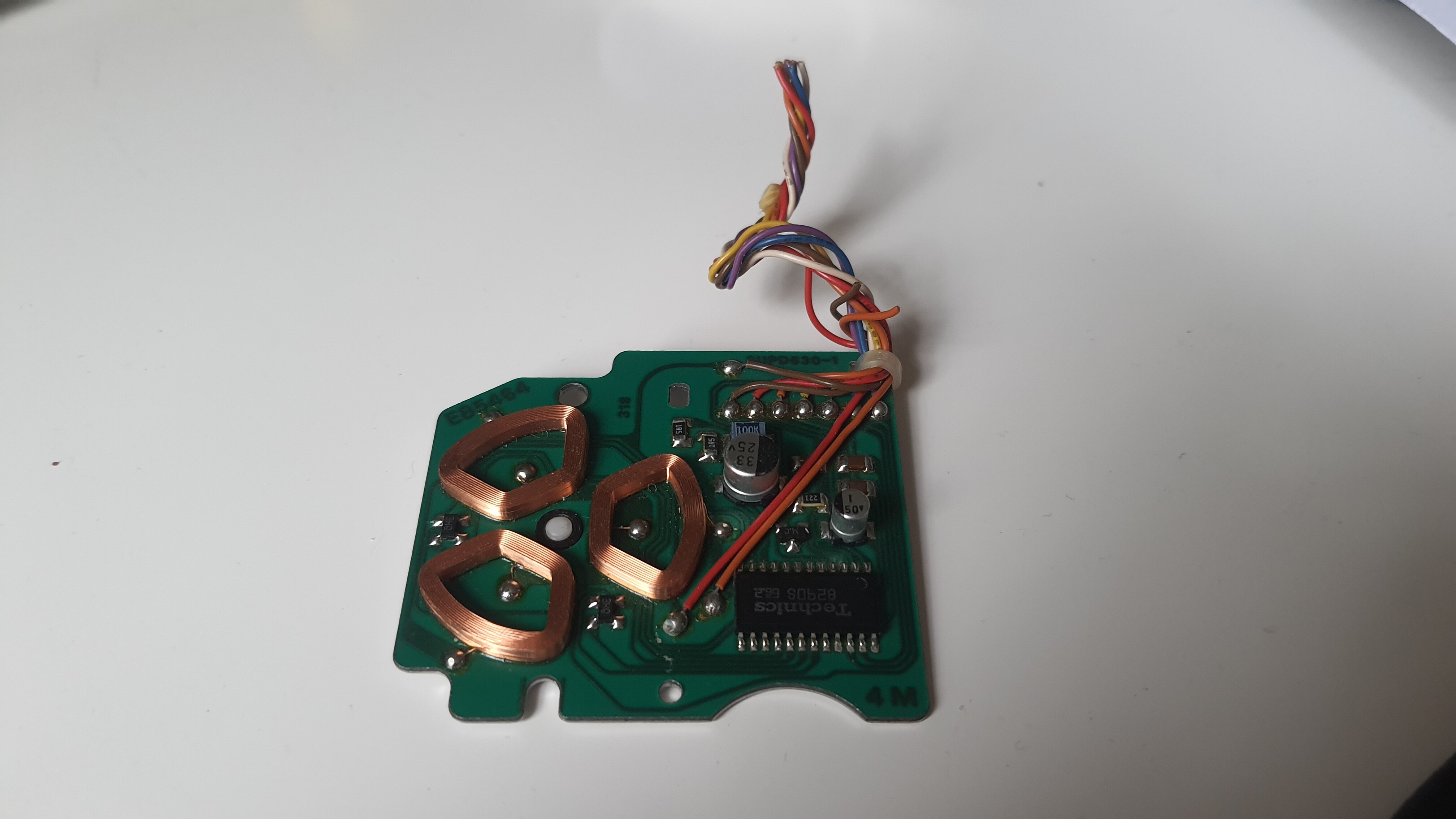

Is this a 3 phase motor?
I think this is from a CD player.
I tried to find a dayasheet for the chip, it might include the motor driver. But I couldn't find anything, so I might make a driver of my own instead.
What I want to do is make this funny shaped magnet rotate "by itself" on a box lid.
Maybe this will help.
AN8290S.pdf (259.9 KB)
Yes, it's a 3-phase set of motor windings. Designed to drive a specific magnet configuration which might not match your magnet as you don't say which way it is magnetised.
I haven't checked my magnet, but I guess its axis is along the longest dimension of it. That would be perpendicular to the axes of these three coils.
That's great help, thank you.
