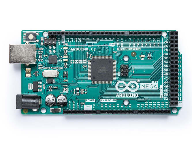

Is this a genuine arduino and why can't I upload?
I bought from an electronics store an arduino (I asked a few times if it's a genuine arduino) but I'm still not sure if it's genuine. I can't seem to upload any code to it.
Here is a photo of my device:

Do you have a CH340 driver?
That is a clone.
Looks like it uses the CH340 USB chip.
So that means it's fake? Because if it is I'll return it and search for an authentic one.
I had the CH340 installed automatically by windows but I re-installed it manually by this website:

A genuine Arduino will have the Arduino logo printed in the PCB
Have you tried a different USB cable?
Are you sure you have selected the correct port under Tools > Port in the IDE?
Make sure you have the correct board selected, Tools > Board: "Arduino Mega or Mega 2560".
Do not use a USB3 port, occasionally those have been known to cause problems.

As far as the board itself, no. "Fake" would apply to a counterfeit board that uses the Arduino trademarks to falsely portray the product as having been manufactured by Arduino.
There is none of that in the picture you posted. This is a "derivative" board, the manufacture of which is perfectly acceptable and ethical.
However, if the person selling the board told you it was a genuine Arduino then they absolutely lied and you should follow up on that unscrupulous (and likely even illegal) business practice.

PS: Yeah I was told this was an arduino and the packaging said "Arduino Mega 2560 R3" so I'm going to have a few words with the shop manager... Is this a problem of this being not arduino or even a genuine arduino has this problem?
