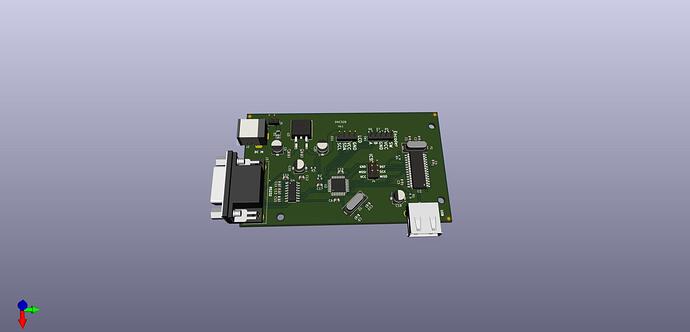

I'd go with something that has an extra hardware serial port that you can dedicate to RS232 comms and not have to share with code debugging or have to use SoftwareSerial. That leaves out the Uno. The Mega has several hardware serial ports. But, IMHO, is too large. I'd look for a board based on 32u4 processor like:
It has native USB for debugging, hardware UART for RS232, SPI for SD card, and I2C for LCD. You'll also need a chip like MAX3232 to convert from UART logic to true RS232 levels. There are breakout boards available.
Also, here's a display. OLED instead of LCD -- Monochrome 0.91 128x32 I2C OLED Display - STEMMA QT / Qwiic : ID 4440 : $12.50 : Adafruit Industries, Unique & fun DIY electronics and kits
Everything can run off 3.3V. With SPI and I2C, you'll still have enough GPIO on the Adafruit board for several push buttons.
For the power supply you may be lucky and find 5volts somewhere on that CNC machine which you can use, which shares the same ground as the RS232 adapter which you will connect to. There are other option like a buck converter if you can find say 12V DC somewhere.
For the screen, one with an SPI or I2C interface is probably the easiest to use without requiring too many pins of the Arduino. Check there is a library to drive them. Usually a single character (including spacing) needs 6 x 8 pixels so anything of 80 pixels or wider should do for 12 characters.
RS232 comes in various voltage levels. TTL (5 volt) , +/-12 volt and maybe others. You should know what this is before choosing an Arduino/RS232 adapter board.
I don't know the CH376S USB (stick/thumbdrive) Read/Write module on https://arduinobasics.blogspot.com/2015/05/ch376s-usb-readwrite-module.html . I had a very quick look. The software needed to run it is apparently quite large and would use most of the resources of say a Uno. You'd also have to check if there is a command available to do a directory listing. I could not immediately find one.
Choice of MCU. On of the new Nano (say Nano every based on an ATMEG4809) may be worth considering although you'd have to check compatibility with the screen, RS232 and CH376S. It has 6KB of RAM and multiple serial ports which has already been mentioned.

Hi, yes is possible, i needed the same tool for old MAHO CNC machines so that was the reason why i started to develop this library. I used M328 MCU (Arduino UNO), I2C LCD, rotary encoder, MAX3232. You have to implement HW or SW or both handshake, otherwise data loss may occur.
