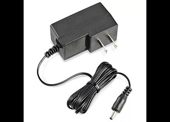

Can the separate power supply be the one from the arduino?

You will need a 5V 1A power supply, maybe a plug in wall adaptor type.
ohh alright,good to know. I'm very beginner on this
Thanks so much for the suggestion, will look that up
Like one of these
