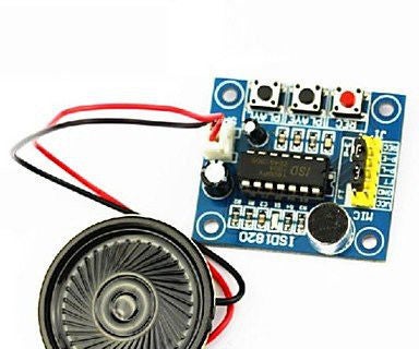

Friend got button and ISD1820 module.
We have problem trying to connect it.
I know there are simpler ways to do it but they choose this type for project.
Button is classic two wires
Can anyone give me some scheme? They told me its not working if they connect to pin on module

Connect the speaker to the ISD1820. Connect power to the ISD1820. That is all the connecting. Buttons are on the ISD1820.

Question is simple, is possible to connect external button to this module?

I know, but they need external button for school project.
This link says "REC" pin is waiting for an external HIGH for recording. Wire a button and a pull-down resistor from this pin to VCC. When the button is NOT pressed, it is held low. When the button is pressed, it shorts to Vcc (HIGH). You need to hold the button for the entire "record" time.
Probably the same for PLAYL pin and PLAYE pin.
