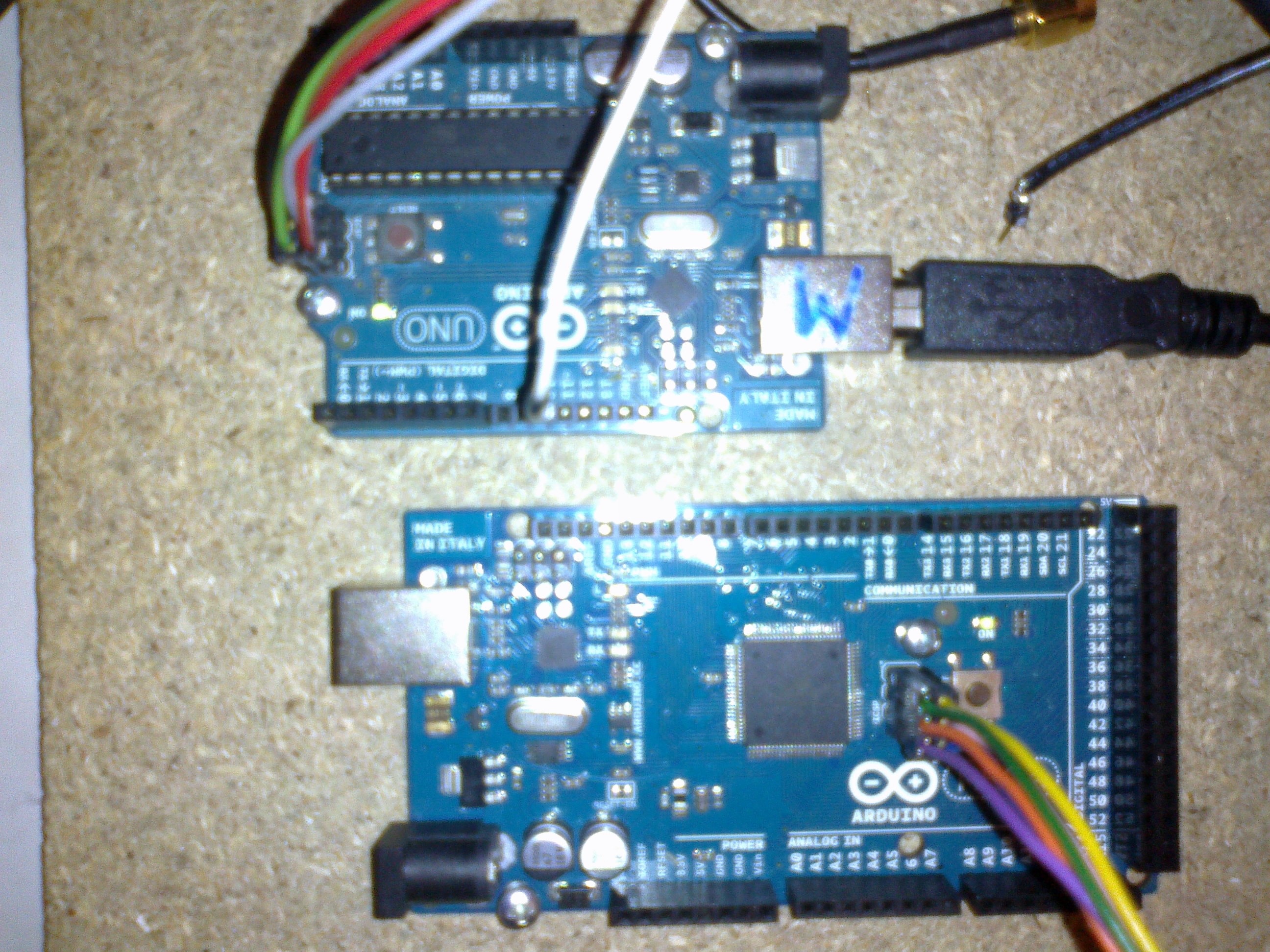

Good Mornining,
Hi I've did the cable the Arduino uno (MASTER) and arduino 2560 (where I want upload my bootloader and after the sckecht) are connected correctly and are turned on .
Now I've download from your link the sketch for BOOTLOADER below reported and I've try upload it inside my ARDUINOMEGA2560,

But I've finished i received back this issues:
Dimensione del file binario dello sketch: 25.442 bytes (su un massimo di 258.048 bytes)
avrdude: stk500v2_ReceiveMessage(): timeout
avrdude: stk500v2_getsync(): timeout communicating with programmer
I've set the programmer like your indication,
what could i check ? Could you send me how need to be setup arduino for uploader the boot loader ?
THanks
Gnux
Show us your fuse settings please.

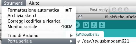

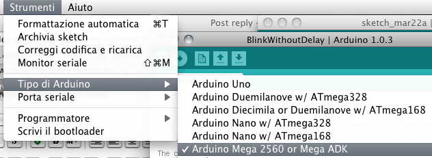

Good Morning
in attachment you can find my connection, the arduino signed as "M" is where i have a usb connection.
in attachment you can find also my Arduino Software configuration.
So with the cable that I've did the arduino 2560 can receive the power and GND, and reset pin is connect into arduino uno D10 like explain into the guide... thanks and
Regards,
gnux
Good Sunday Nick :slight_smile: i hope the information that you need are enough ... sorry if ask you trivial question but It's the first time that I try to programming my arduino in this way :slight_smile:
