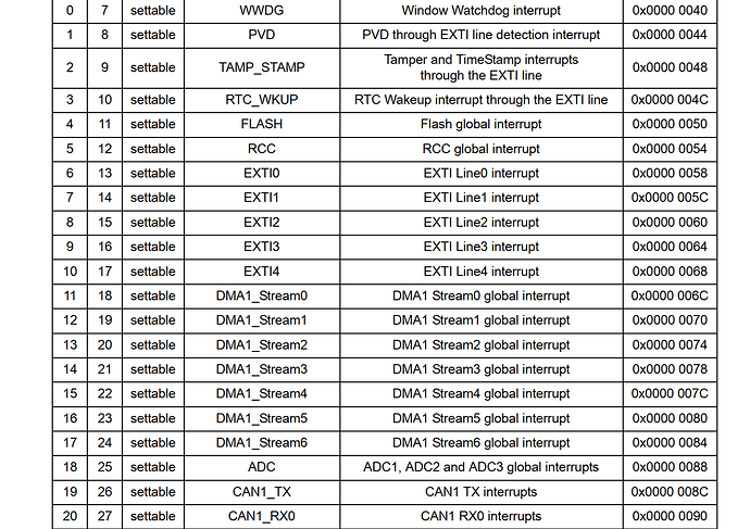

Oh I thought the n was a placeholder for the pin number. What does TIM7 stand for? Or is there a table where I can look up all the ISR names?
The datasheet of the MCU should have a table describing all the interrupts, normally under section Nested Vectored Interrupt Controller (NVIC). From there, its just a matter of adding _IRQn when coding for the ISR
