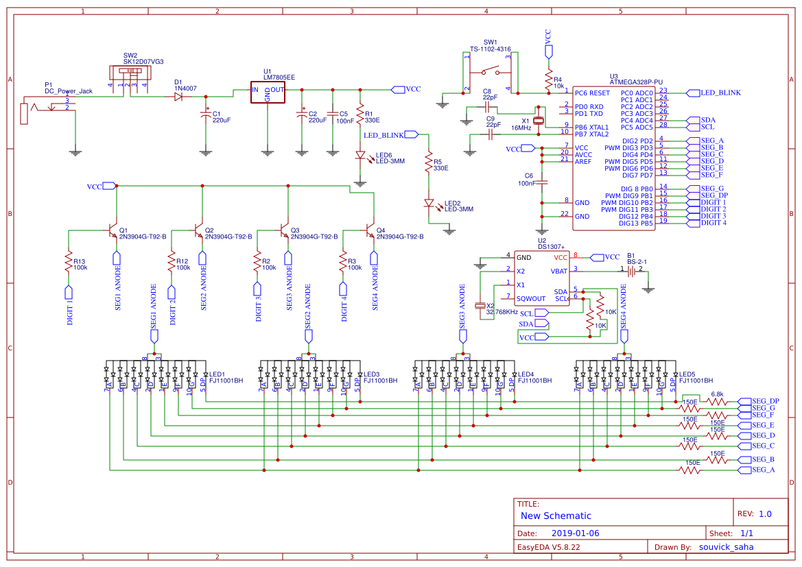

Here's the schematic of the instructables project: [https://content.instructables.com/F2O/RWID/JQWT42D7/F2ORWIDJQWT42D7.png](https://content.instructables.com/F2O/RWID/JQWT42D7/F2ORWIDJQWT42D7.png)
and the original instructables: [https://www.instructables.com/DIY-Digital-Clock-With-7-Segment-LED-Display/](https://www.instructables.com/DIY-Digital-Clock-With-7-Segment-LED-Display/).
For some reason the forum didn't allow me to post more than two links since I'm new here, sorry about that.

![F2ORWIDJQWT42D7](https://europe1.discourse-cdn.com/arduino/original/4X/7/1/0/710915bc54f964adbfd2519252eee7f912cc3882.png)
Segments E, F and G are on with A and B glowing. In what state is the code (running? not?) Have you looked underneath for a missing penny or bent pin(s)? Do I see two bent pins on U1?

> [@RElectronics](#):
> I used an Atmega32u4 for my project
The schematic is for an ATmega328P. You can't use the same schematic for an ATmega32u4. I'm sure the Arduino pins map to different physical pins.

Okay. This shows what pins are effected.
If you applied power to the board (no code running) and the segments in the photo (e, f and g) are lit, that would eliminate code from being wrong.
The 7segs are "a" at the top, going around clockwise through "f" then the center is "g" (with "h" as a decimal point). The "always lit" segments are e, f and g. The number 2 uses "e" and "g" of these three segments. That tells me that e, f, AND g are "forward biased" (+ on the anode, - on the cathode) without being told to by the running code. In "arduino" code, that would mean the "anode-connections" of e, f and g are "high" when they should not be.
I would look at "what drives (provides forward bias to) the segments.

Are you certain you have the correct pin number for the E and F segments? On the Leonardo pinout PD4 is D4, PD5 is the TX LED.
In the schematic, the transistors driving the displays would turn on with a LOW output, your code looks to be using a HIGH output.
\< edit \>
The code in setup() to set the output mode for the pins also appears to be wrong, you are not usings pins 2 through 13.

Vf on a GREEN display is 2.4V. The pn (and hence driver) is for a RED (1.7V) display. The project is shown running from 3V3. The drive transistor only has .7V across it, your design is marginal just on a superficial inspection. Since the pn is incorrect, it could be common anode vs common cathode too.

PD5 is pin 22 which connects to TXLED and PD4 is pin 25 which connects to digital pin 4, looking at my schematic and the atmega32u4 pinout that part seems fine. I see what you mean with the for loop in the setup, the reason the person who made the project did this was because they tied the pins A through G sequentially, so because of the way I made my board I can't exactly do this. I'm assuming then I can't use a for loop to turn on the segments at all, but rather write a pinmode for each one individually?
