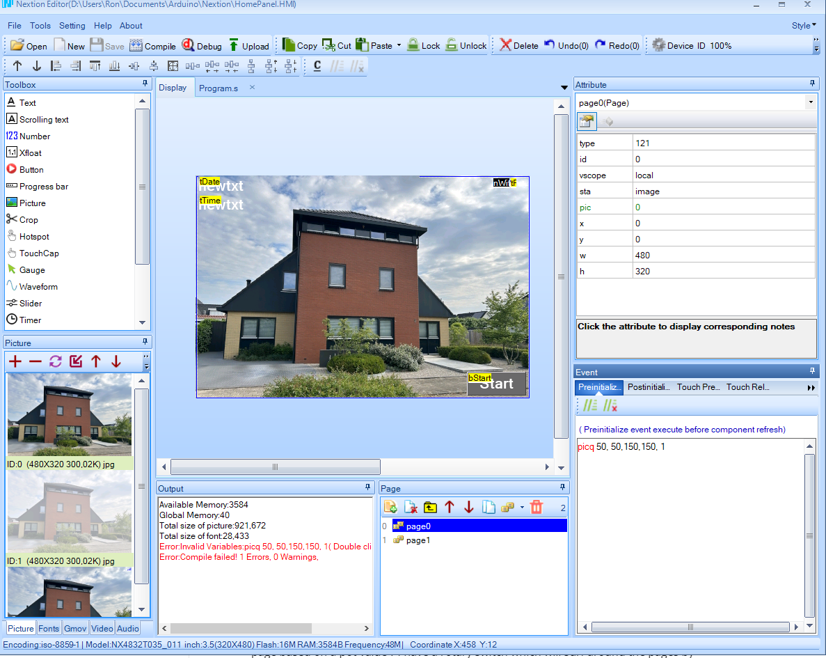

Trying to work with Nextion and playing with picture manipulation.
When using picq function I get an error stating: Error:Invalid Variables:picq 50, 500,150,150, 1
There are no variables used in this function.
What am I doing wrong?
See all in this screen shot:
Gr,
Ron
picq 50,500,150,150,1

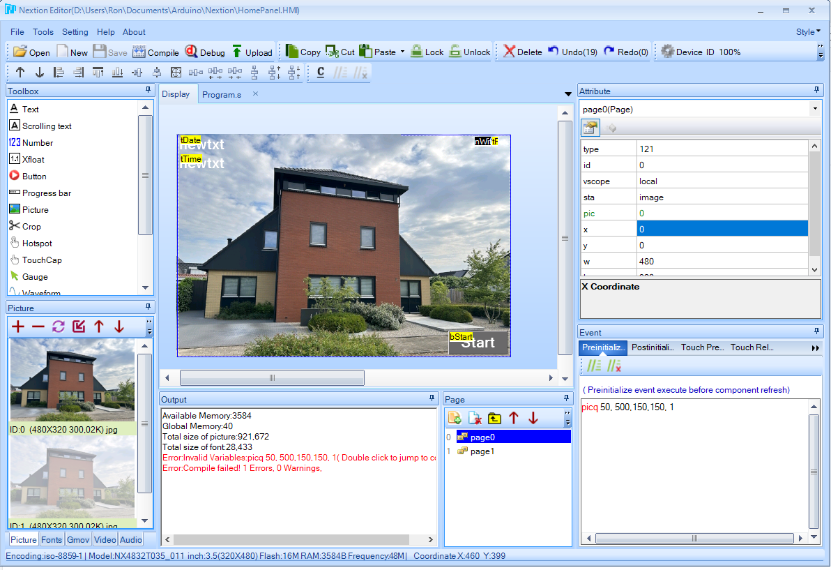

If you have a 480x320 display then the 500 value is out of range.
From the Nextion Instruction Set
https://wiki.iteadstudio.com/Nextion_Instruction_Set#picq:_Crop_picture
picq: Crop picture
picq x, y, w, h, picid
x: x coordinate starting point;
y: y coordinate starting point;
w: area width;
h: area height;
picid: Picture ID;
  • Example:
picq 20, 50, 30, 20, 0 //Crop the area from starting coordinate (20, 50) , with a width 30×height 20 size, //in the picture 0 (the background picture must be full-screen) and display it on //the screen, and the display coordinate is the starting coordinate (20, 50).
Remarks:
This instruction requires that the background picture must be full-screen; otherwise, the image you crop is not the one you want. The crop image area and the display area is overlap on the screen.
When changing the 500 to 50 (was a typo in the picture I tried to make for this topic) it still shows the same error.
You are cropping picture id 1 but the pic for the page is shown as pic 0. What if you change the crop instruction picq to 50,50,150,150,0 .
I get the same message.

Try with the picq instruction as a PostInitialization event instead of a PreInitialization event.
In my experimenting with picq I have gotten the croped image to display properly as a post, touch, or release event but not as a PreInitialization event.
Hi Cattledog,
Thanks for having patience with me.
I tried to put the picq in those events and still the same erre.
What is not clear to me is the message talks about variables in the statement where I only use numbers.
I just did a test with only having one page in the HMI file and two pictures. The same error message.
I have seen examples on the internet where this works: two full screen picts using picq to overlay a part of one over the background pic.
I think I found the issue: spaces in the picq command after the "," separators (like usual to do when programming for reading).
Aftre removing those and putting the statement in the post initialization it worked.
