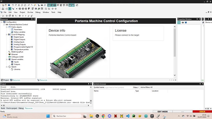

I've managed to see my Portenta board and download the code to it. All the digital outputs pin are blinking red as they should. I've then set up the communication but when I try to connect I get an error message in the right corner.
 ![image](https://europe1.discourse-cdn.com/arduino/original/4X/5/0/4/50465ce58a04e1487a10836bfc726cbf5d87c090.jpeg)

@porthos_7 Thank you for your reply.
This behavior may be encountered when configuring the Portenta Machine Control for the first time in the PLC IDE.
It is recommended to:
- Upload the QSPIFormat sketch available in Arduino IDE \> File \> Examples \> STM32H747\_System \> QSPIFormat. Then, check the output of the serial monitor.
- Implement the [Memory Partitioning tutorial](https://docs.arduino.cc/tutorials/opta/memory-partitioning/). Make sure the code execution is completed successfully by following the output of the serial monitor.
If these steps are completed successfully, you can close Arduino IDE, go to the PLC IDE and create a new project. Then follow the steps indicated here [https://docs.arduino.cc/tutorials/opta/plc-ide-setup-license/#2-project-setup](https://docs.arduino.cc/tutorials/opta/plc-ide-setup-license/#2-project-setup).

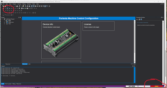

![image](https://europe1.discourse-cdn.com/arduino/original/4X/a/4/6/a468802f329cd1b8e13920b7936aa5fffa9158ab.png)
I also have the same issue. Every time I try to connect my machine after downloading, the PLC IDE crashes and won't do anything until I force the com server to close. Only after this does the error appear in the lower right corner
