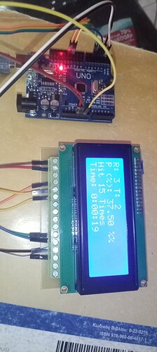

Hello, i recently made one project which worked well for the rest of the time but at some point faulted. The issue is that in the 2 row in which this text is print on it
lcd.print(String("  P (%): ") + ((float) programVariables.timesHit / programVariables.timesRan * 100.0) + String(" %"));
the String(" %") sometimes may get print for the second time therefore resulting in 2 percentage characters together instead of one.
Code:

This does not always happen after uploading the code nevertheless sometimes it happens. Moreover, i also noticed this happens after very long hours of uptime.
I suspect that you have printed a value with more digits at one point in time.
You could add a trailing space, i.e., "% " to make sure the character is overwritten. Alternatively, you could use a fixed width format that adds leading zeros or spaces.
this cast to a String object ist not necessary:
but you could (and should) use the F-Makro with fix text:
lcd.print(F("Hit ? Times"));
That was it! Thank you with the assistance. I did not have in mind that i must overwrite all of the characters. Cheers.
Also thank you for the reccomendation, i am relatively new and this is much assistance in my learning. I agree with your statement aswell.
