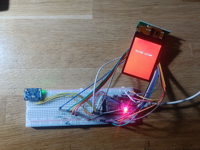

Hello,
I am trying to make a thermostat for my central heating. I decided to include a touchscreen capable display for ease of use. I have bought this display:
I am using this esp32 module:
Using Adafruit_ST7789 library I was able to get things to display (hello,world and a 'blue' background color).
The problem I am facing is that the text is mirrored(or flipped) and blue is actually red(see photo below)
All 4 variants of tft.setRotation do not produce valid results. I tried writing to MADCTL directly from code, but the library defines it and cannot be overwritten.
This is my code:

Update : fixed the mirroring of the text, now i am trying to get colors to work right.
Thanks !

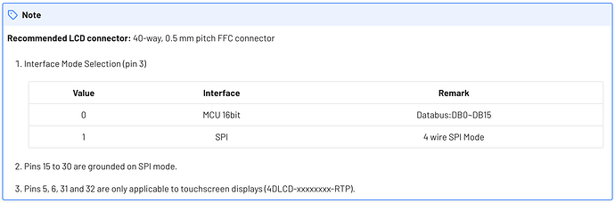

Your display has 2 I/F , 16bit parallel and SPI.
Is the following code for selecting SPI?
No, this is for writing in MADCTL register (see ST7789V datasheet) which should take care of the orientation of the displayed image. However, orientation is working as intended now.
SPI is selected through physical wiring.

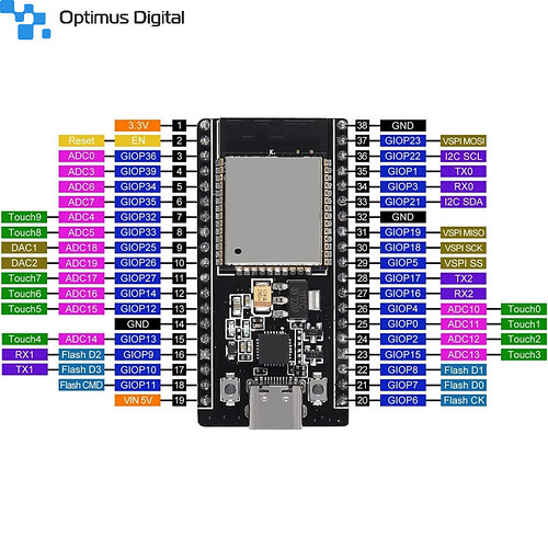

if I use the above pins the ESP32 program crashes and goes into a reset loop
looking at ESP32 Pinout Reference: Which GPIO pins should you use?
GPIO8 is connected to the integrated SPI flash
GPIO9 is connected to the integrated SPI flash
what specific ESP32 are you using that you are able to use GPIO8 and 9
This is an error of mine, do not take this in consideration (written by ChatGPT).

#define TFT_RST  9
#define TFT_DC   8
using GPIO 8 and 9 cause my ESP32 to crash and go into a reset loop

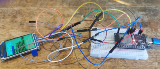

yet you show a photo with the display working
did you run the program of post 1 to get the photo or another program?
Hi Horace.
Yes, I know about those errors in that code. That is not the code I used, unfortunately, I've lost the code I used when the screen was working. That tft.writedata should be TFT.write16, and I triple checked the pins, they are correctly wired. You can use the graphicstest_st7789 from the library.
Are you trying to recreate my issue?

My testbed
Test program
This program is a little hard to read, but it uses Adafruit and TFT_eSPI to control RGB and GBR using low-level functions with MADCTL.

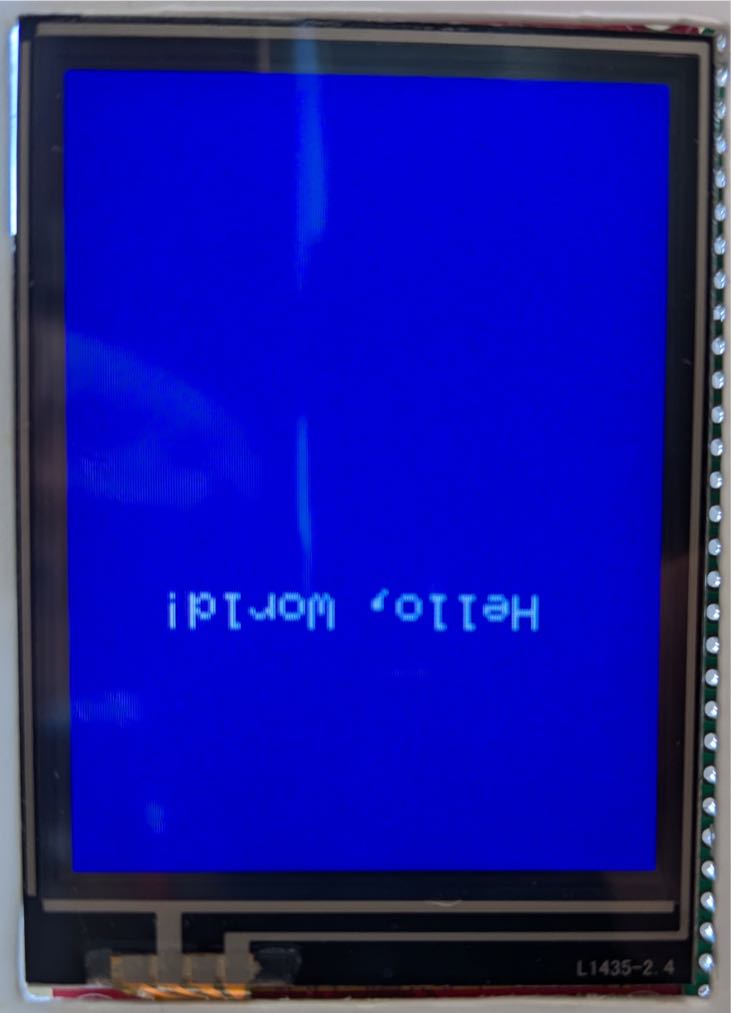

Result of Adafruit
When I run this program, it fails to rewrite the flash unless I start the bootloader. This may be due to the use of low-level functions.
@cpaul09 , I brought up TFT_eSPI because we talked about RGB and BGR, but like @horace did, why not go back to basics and start with something that works with Adafruit?
And please post your full scketch (without MADCTL part). Something should work.
