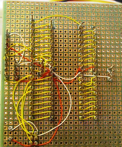

I posted pics of my wirewrap test card in another thread recently, it that has no ground rings, all parts in sockets, bootloaded via Atmel AVR ISK MKii and downloaded with FTDI module - all with no issues.

Really, wirewrap is just a step above breadboarding - I've breadboarded these without issue also.
I really don't understand where the issue is.
Maybe crappy crystals elsewhere?
Even there I just use generic stuff
http://www.dipmicro.com/store/XC7-16000
Part in the picture has no branding, just says 16.000
