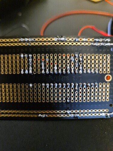

Hi everyone, I was hoping I could have some help as I very stuck. So I had my project working on a solderless breadboard, and the circuit was just controlling a mini 12v air pump with an atmega328p.
However I have just soldered everything to a permanent board and now when I plug it nothing works and makes my plug make a hissing noise, and the LED from the plug turns off (when it is normally on all the time it is plugged in).
Below I have attached the schematic for the circuit.

You have a short somewhere. Examine your wiring for solder bridges and shorts.
Post clear photos of your project. Maybe a few more sets of eyes can spot what you are missing.
I thought that but i couldnt see any
Use your DMM to check for shorts.

You have a BLACK wire going to +ve?
yer forgot to mention that I just accidently put the colours on the wrong way around
You should get out a multimeter and poke around for shorts. What you miss with your eye, a resistance of 0 ohm you will definitely catch. Check any lines that are in any physical proximity.
You have probably did this already, but make sure you have triple checked the wiring, I have from time to time put a wire or something in the wrong place on the soldered version, have also missed soldering a connection sometimes.
Do you still have the breadboard you can check against? I always keep the prototype set-up until the soldered version is running.
