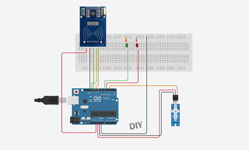

Issue with RC522 "Firmware Version: 0xB2 = (unknown)"
I only started coding on Arduino and RC522 like 2 weeks ago and I've been having this problem recently, I use the MFRC522 and Easy MFRC522, also Adafruit BusIO Libraries
Here's my code

here's the wiring diagram (I got it from youtube)
Thanks!
The "Firmware Version" might not match the expected values in the library.
Add this block after mfrc522.PCD_Init(); in setup() to verify the firmware version:
byte firmwareVersion = mfrc522.PCD_ReadRegister(mfrc522.VersionReg);
Serial.print("Firmware Version: 0x");
Serial.println(firmwareVersion, HEX);
if (firmwareVersion == 0x92) {
  Serial.println("RC522 v2.0 detected.");
} else if (firmwareVersion == 0x91 || firmwareVersion == 0x90) {
  Serial.println("RC522 v1.0 detected.");
  Serial.println("Unknown firmware version. Check connections.");
If the firmware version still shows 0xB2, it's an indication of hardware communication failure.
I added the code in and the firmware version still showed 0xB2
How do you think I could fix it?
I ended up fixing it by replacing the whole board thanks for the help though
