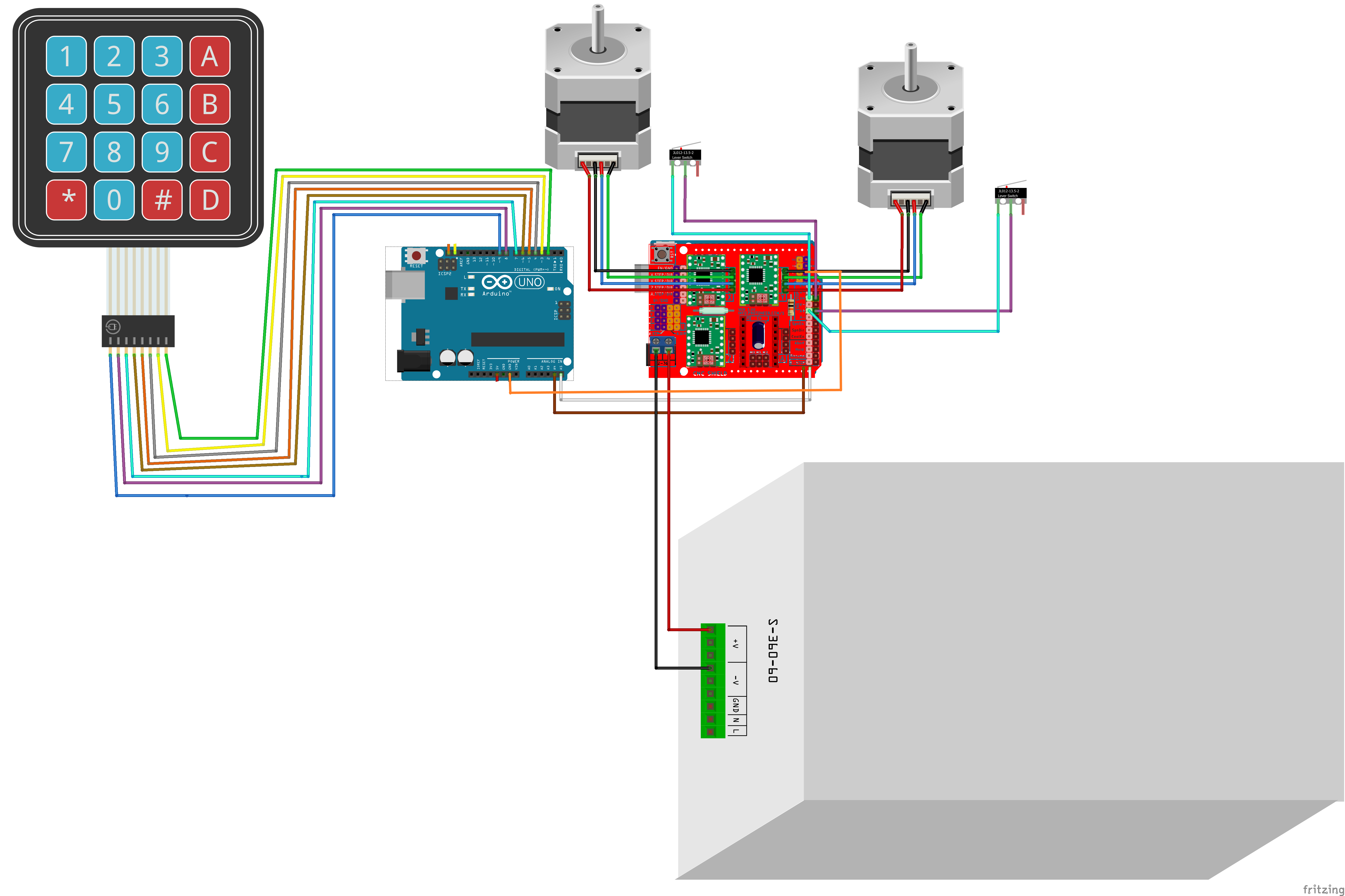

Hello, I am a 12th grade high school student working on a Sand Table, modeled after this project: https://www.instructables.com/Build-a-Mesmerizing-Sand-Table-a-DIY-Arduino-Maste/
I am using an arduino uno with a keypad to communicate via I2C to an arduino uno and cnc shield, which controls the NEMA 17 stepper motors. I have attached an image, which is from this project: GitHub - maddaxlallatin/grizzlyGuide
The only difference between this wiring and mine is I have omitted the LCD screen and added a wire between the ground pins on the arduino and CNC Shield.
I have run into an issue with my stepper motors where they are turning in the wrong directions inconsistently. They were turning correctly at first, but then after I connected a wire between the two arduinos' GND pins, this issue has began. Even after removing the wire, it has persisted. On the serial monitor, I can see that it always runs the correct function, but it will frequently move in the wrong direction. I don't see a pattern in when/how the motors malfunction, so I am quite lost.
I am very new to this, so any help/suggestions are appreciated! Also, please let me know if I should provide more information about my project.

Both are turning the wrong direction? You are writing to the wrong motor.
Once a week? Be descriptive.
You disturbed a connection. Either good to bad, bad to another bad, or bad to worse.
  1. Disconnect everything.
  2. Run an I2C bus test for the LCD and motor shield.
  3. Connect the LCD to the Arduino and make it work.
  4. Connect the keypad to the Arduino and make it work with the LCD
  5. Connect the motor shield to the Arduino and make it work with the LCD and keypad. Are the I2C addresses correct?
  6. Connect the limit switches to the motor shield and make them work with the other stuff.
  7. Post a drawing of your wiring (NOT a bad drawing with an explanation of how it is bad).
Another advice is to try to run the motor with no load.
If the problem vanishes, your code will probably be okay.
Here is an updated wiring diagram. I apologize for not updating it.
I don't think rewiring the whole thing is going to be useful, as the problem is only in the motors. The I2C connection works great, and there are no problems there. Here is a video of the problem; I think this will more accurately illustrate it. https://youtu.be/vgBERxAF3y8
I have it set to move in a loop: up, down, left, right. As you can see, it sometimes moves in the correct direction, but it seems to randomly go in the wrong direction other times. I have done many trials, and the issue does not seem to occur more frequently in a particular direction.
I'm going to test the motors individually with no load, will update on how that goes.
Thank you for the help!
After testing both motors, it turns out that the second motor was the one acting up. One of the wires to the motor came loose, and after fixing it it works as intended!
