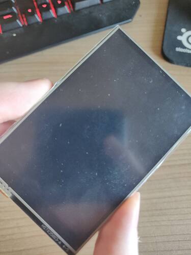

Hello, I'm a student learning Electrical engineering, and I'm trying to make a small project, but the LCD screen I bought from aliexpress : https://www.aliexpress.com/snapshot/0.html?spm=a2g0s.9042647.0.0.30544c4d3qGAvl&orderId=8129352010671823&productId=1005001297902098 seems to not be working.

Is there anything that can be done? The LCD screen is on but black screen.

Here are some pictures of the device, if that helps.
Ok, so I did everything like you said, I did have to install Adafruit GFX, cause, the code is asking for that libary. Now it outputs this code.
Serial took 0ms to start
ID = 0x101
The screen is still blank, and this is the code I ran

I give up. I gave some clear steps. I expected to see:
ID = 0x101
void setup(void) {
    uint32_t when = millis();
    //    while (!Serial) ;   //hangs a Leonardo until you connect a Serial
    if (!Serial) delay(5000);           //allow some time for Leonardo
    Serial.println("Serial took " + String((millis() - when)) + "ms to start");
    //    tft.reset();                 //hardware reset
    uint16_t ID = tft.readID(); //
    Serial.print("ID = 0x");
    Serial.println(ID, HEX);
   if (ID == 0xD3D3) ID = 0x9481; // write-only shield
    if (ID == 0x0101) ID = 0x9481; // write-only shield
    ID = 0x9481;                             // force ID
    tft.begin(ID);
I did NOT want to see the whole sketch pasted.
Anyway, your edit was correct. If you have completed (1) and (2) correctly from #11, I would have expected success.
If you are in the UK, please send me a PM. (Private Message)
David.
Sadly, I'm not in the UK.
I'm very grateful that you took the time to help, me thank you for that, I'm sorry I wasted your time with this awful product.
Could I ask one more thing from you? I would love to finish this project, and I need to buy a new display, can you tell me which one shouldn't have any issues? I live in Latvia, so any stores that sell it, have to have an option to send it in the post.
Richard.
Ask AliExpress for your money back. The item is faulty.
I know nothing about Latvian shops. I have probably only bought displays from China.
If I need some components urgently I buy from UK Distributors or UK Ebay sellers. More expensive than China but the items are delivered in 24-48 hours.
David.
I did ask AliExpress for my money back Thankyou.
