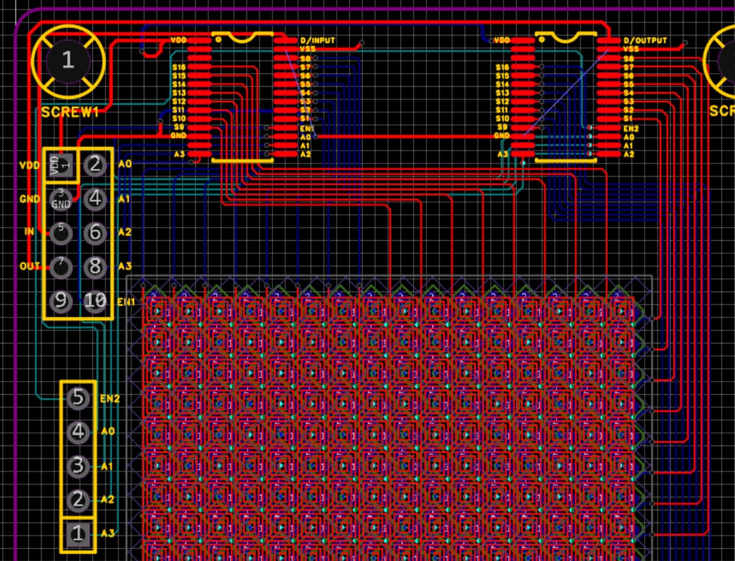

Hello everyone, I am a beginner in programming and have encountered some issues. As shown in the diagram, the bottom right corner features a 16×16 coil array. I am using the ADG1606 on the upper left of the diagram to control the 16 columns and the ADG1606 on the upper right to control the 16 rows. I connected the 2×5 switch chip and the 1×5 switch chip to an Arduino, aiming to use the Arduino to control the first row of coils to open and close sequentially.
My connections are as follows:
The VDD and GND of the 2×5 switch are connected to the 3.3V and GND of the Arduino, respectively. The A0, A1, A2, A3, and EN1 of the 2×5 switch, as well as the A0, A1, A2, A3, and EN2 of the 1×5 switch, are connected to the Arduino's digital ports 2 to 11.
However, during the experiment, the IN and OUT terminals could not connect to the power supply, and I was unable to make the first row of coils open and close as intended. My program is shown in the diagram.

What diagram?
What power supply?
@zhegeren23

Apologies for any confusion caused by the wording in my translated text, as I used software to translate my statements into English. By "diagram," I am referring to the PCB layout I provided, and by "power supply," I mean an external voltage source I am using.

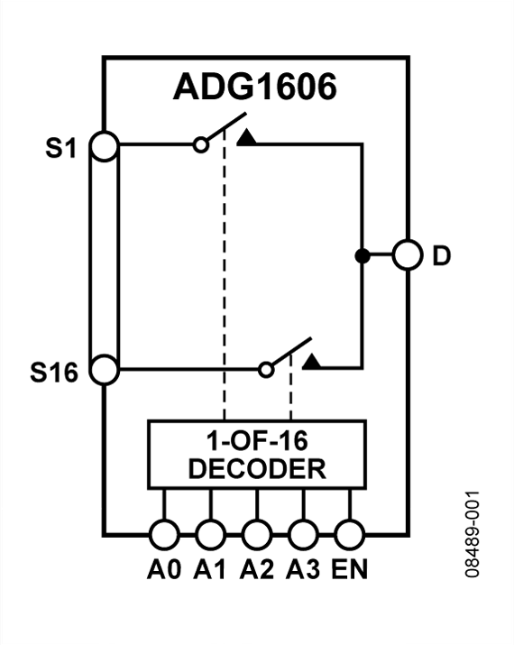

The ADG1606 I am using is the one shown at the top in the two images you provided.I configured the D pins of the ADG1606 that controls the columns as inputs, connecting them to the positive terminal of the voltage source. For the ADG1606 that controls the rows, I configured the D pins as outputs, connecting them to the negative terminal of the voltage source.
