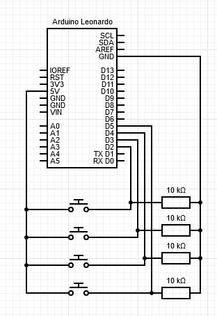

Interesting question but hard to follow. Lets start with an annotated schematic as to how you are connecting all of this . Post links to technical information on the hardware devices. Show values of external components and any level translators you are using.
Sorry for the lack of useful information. Thanks for pointing me towards what I should be providing:
Here's a quickly drawn schematic of what's going on (pretend like it's an Arduino micro, they didn't have one in the software I was using):
Here's a pastebin to the code written for the Arduino: DanceMat Code - Pastebin.com
It's a very simple code that watches for the pins to get pulled high, and writes a button press with some level of debouncing (the buttons I am using are the pads on the dancemat so there is quite a bit of bouncing when pressed).
I want to reiterate that on Windows, this code and my wiring works PERFECTLY. It never miss-inputs, it always triggers when I expect it to, etc. I have also tried using Keyboard.h, and that also works on my windows machine perfectly, but no matter what on my raspberry pi I just get all of the buttons pressing randomly.
Specifically, I am getting the buttons I have programmed pressing randomly. In this code, buttons 1,5,7, and 3 are coded, and only those buttons are going haywire when plugged into the raspberry pi 4. The same is true when I write code that was meant to press up/down/left/right on the keyboard. Only those were being pushed, so the communication protocol over usb is transmitting the button codes properly.
It is important to note that the buttons are self-made, and they are two metal bars (~1in wide, and ~3 in long and ~.25 in apart, and there are 4 switches in parallel per pin) that are separated by foam, and when the pad is pressed, the metal bars touch to complete the circuit. So hypothetically I could see those buttons working as a weak capacitor, so if there is a difference in how a raspberry pi (or my powered usb hub) would power the +5v pin from how a Windows laptop would drive it, I could see current getting through the pads when they are not pressed.
Hope that explains things better, I am not the best communicator when writing out issues I'm dealing with.

Also, as a side-note, you probably don't need to use separate resistors if you initiate the pins with INPUT_PULLUP instead of INPUT. It handles the pull-up resistors internally. Note: it will swap open and closed in doing so.
