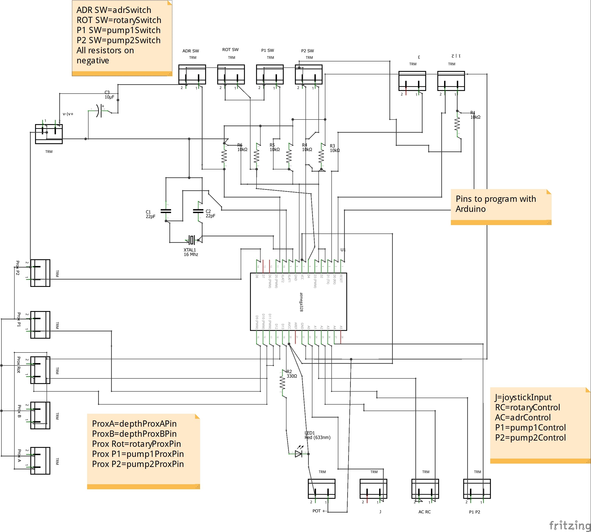

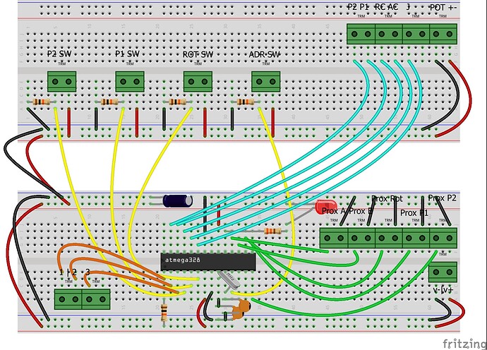

This is a jpeg export of the fritzing document.
We need a circuit diagram. Fritzing pictures will just put people off responding to you. You can attach your complete .ino code if it is to big to list in code tags.
Fritzing diagrams are intended as simplified build instructions for those building stuff on breadboards that dont understand circuits or schematics.
If you want experienced people to tell you why a circuit may not work, publish a schematic, an image of a pencil and paper drawing is fine.
srnet:
Sorry, I'm rather inexperienced with the whole Arduino thing anyways. I used the Fritz to create a schematic and also included the schematic that was provided on dronebotworkshop to create the standalone Arduino. Hope this is what you are looking for.
Regards,
Well it's close, but no cigar. A proper circuit diagram looks something like this, although not a wonderful example, you will see how it is laid out logically and without litle zigzags on pinouts.:
Both of those diagrams are missing the required 0.1uF decoupling caps on the power supply pins. Vcc to ground and AVcc to ground.
I hope that your project is not actually wired like the fritzing shows. Sorry, but there is no way that anyone could build a working circuit from that diagram. For instance, look at where pins 2 and 3 or 10 and 11 go.
groundFungus:
Not sure I understand where they go but I used a 10uF capacitor tied into the VCC and AVCC.

You need a 100nF (0.1uF) across the rails at each active device, as close as possible to the device pins. It is there to handle high frequency noise.
AJLElectronics:
So like I did in the attached schematic?
Those caps across all the terminal blocks may or may not be required. We have no way of knowing since you haven’t told us what’s connected to them and since getting a usable schematic appears difficult, how about you show us what your creation looks like. A few decent, in focus photos are worth thousands of words.
How did you have things built such that worked with an Uno? It would help if we knew more about what is attached to all those terminals and a much better description of how the project is failing. How you you know it’s not 40 milliseconds? Do you have a scope?
We are happy to help but so far, we lack the required information to help you help yourself.
I connected everything to the uno and had no issues, when I connect the same wires to the breadboard locations on the ATMEGA328 as they relate to the Uno they don’t work properly. As far as a schematic is involved it’s the best I can do as I never drew one up. I’m out of town so I can’t get pictures and won’t be able to for a few weeks. I was hopeful that there is some difference between the uno and the ATMEGA328 “uno” I built.
As far as what they connect to, the outputs connect to a proprietary junction box that looks for an on-off signal, my issue is that the ATMEGA328 does not output the on-off signal steady.
There are numerous differences between an Uno and an atMega328 on a breadboard. The most obvious ones, as they relate to your project, are 1) power supply 2) bypass capacitors 3) reset circuitry.
  1. How are you powering the breadboard?
  2. You absolutely need a 100nf ceramic capacitors across the VCC/gnd and AVCC/gnd pins of the processor directly on the processor pins, not connected with jumpers off on a corner of the breadboard somewhere. A single 10uf capacitor is not better because it’s a hundred times larger in value.
  3. Why is the reset pin being brought out to a terminal strip? That factor alone could be causing spurious resets of the processor.
On a side note, the led on pin 13 cannot work as shown, it’s backwards. As shown with the anode connected to pin D13 through the 330 ohm resistor, the cathode must be grounded in order to illuminate when D13 is high. If you want it to illuminate with D13 low, connect anode to VCC and cathode to 330 ohm then to D13. Cathode is the lead with the flat side.
Start by fixing the led and use the blink sketch to insure the processor runs properly.
Anomalies with bypassing and the reset pin will many times be obvious with the blink sketch misbehaving.
WattsThat:
  1. With a 120VAC to 5VDC power supply
  2. So remove the 10uF capacitor and install 2 100nF capacitors, one from pin 20 to ground and one from pin 7 to ground?
  3. I have a 10 kOhm resistor from pin 1 to ground.
  4. I screwed up when I created the schematic for the LED, it works properly I just need to fix it on the schematic.
