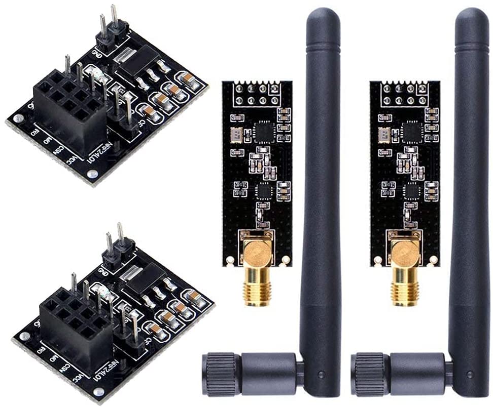

Hello,
I'm having some issues with a project I'm trying to copy from Wireless Laser-Gate Timing System for Track and Field
Here is a video which will give you a good ideas how it functions. Video of timing system
I've built this project several times due to thinking it was bad soldering and cabling..etc. However, I had the same issue each time. The project functions ok when you turn it on for the first time and run the timer. When you break the laser the timer is stopped the time is displayed on the lcd module. Now here is where the problem starts....when you press enter to clear the time and return back to main screen the wifi modules loose connection (or don't reconnect?). The only way it works again sometimes is if you turn off and on the start module again.
I'm using the NRFL24L01+ modules with the breakout board. I did notice on one of the builds that I did (by accident), if the GND cable on the NRFL24 module (breakout board) that connects to the Arduino for the Start module was disconnected it would sometimes work. However, i'm assuming that if the GND cable was disconnected it would cause damage to module.
I've attached pictures of the modules I'm using. I've used multiple modules from different vendors and i'm having the same issue.
If you someone can help me I would be most grateful. If you require anymore information just let me know. Thank you.
Have you verified the proper function and wiring of your radio modules using only example programs that you did not modify?
If you can't get a simple "Hello World!" type of communication going, trying to debug the radios in the context your large program is insane a waste of time.
Sry if you did say somewhere in there that you had done.
