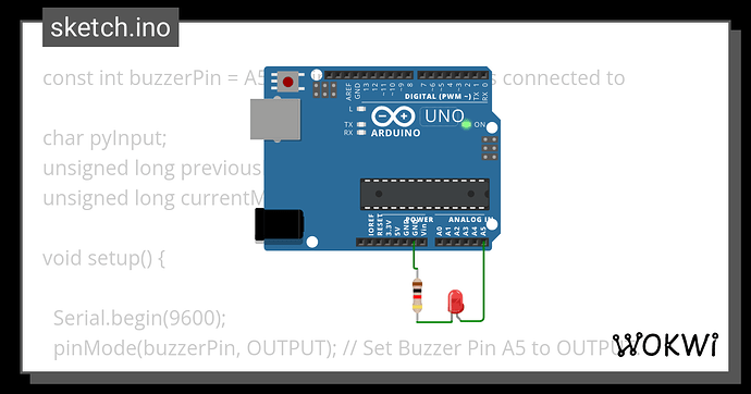

I have an issue that I can't solve so any help is appreciated!
The code includes a function with two variables (number of repetition and duration).
The idea is for the active buzzer to play a different sequence depending on the character ('p' or 's') that is entered in the serial monitor by the user.
However, this doesn;t work as indented. If I press "p" or "s" I get a continuous beeping until I press again the same key where it stops beeping. More like an ON/OFF toggle.
I also included a wokwi but with a LED instead of an active buzzer but the begviour is the same of course. Thanks!

This should be a while so that the code loops inside the function
You also need to reset the value of pyInput after calling buzzerBeep so as to avoid it being called again
Thanks UKHeliBob,
Replacing the 'if' with 'while' will defeat the purpose of using millis() as it'll pause the execution, no?
Yes it will, but your current code won't work at all using an if because buzzer_toggleCount will always be less that top
You need to restructure your sketch so that it tests whether the required number of LED flashes has occurred and, if not, does another one

Take a look at this
const byte flashPin = 3;
    pinMode(flashPin, OUTPUT);
    static bool flashing = false;
    static byte targetCount;
    static int interval;
    if (!flashing)
        if (Serial.available())
            char inChar = Serial.read();
            if (inChar == 's')
                targetCount = 4;
                interval = 500;
                flashing = true;
            else if (inChar == 'p')
                targetCount = 8;
                interval = 200;
                flashing = true;
    if (flashing)
        flashing = doFlashes(interval, targetCount);
bool doFlashes(int interval, byte targetCount)
    static byte flashCount = 0;
    unsigned long currentTime = millis();
    static unsigned long prevFlashTime = 0;
    if (currentTime - prevFlashTime >= interval)
        digitalWrite(flashPin, !digitalRead(flashPin));
        flashCount++;
        prevFlashTime = currentTime;
        if (flashCount >= targetCount)
            flashCount = 0;
            return false;
            return true;
Thank you! I will try it s soon as I get a moment. Also, I need to read it a few times to digest it. :slight_smile:
It seems to behave as expected. Many thanks!
