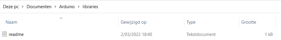

Hello! I wanted to include the following library in my Arduino IDE code: #include <AltSoftSerial.h>, but I got an error saying that "AltSoftSerial.h: No such file or directory". So, I wanted to include the zipfile of the library, but then the error said that "the library already exists". This question has already been asked a few times on the forum, but I did not find an answer that worked for me, because people responded by saying that the library was in the sketchbook and that it had to be deleted. I looked into my sketchbook and found nothing:
I also looked into the the inherent libraries of the Arduino IDE and didn't find the AltSoftSerial.h library:

Did you happen to look into the Arduino libraries folder where all the libraries are stored?
I think that's the folder on the second screenshot

it is 4 places where a lib can be:
  • C:\Program Files (x86)\Arduino\libraries,
  • C:\Program Files (x86)\Arduino\hardware\ .....\libraries,
  • userFolder\AppData\Local\Arduino15,
  • yourSketchFolder\libraries
It worked! Thank you! I found the files in the third option: AppData>Local>Arduino15>staging>libraries and deleted them. When retrying to include the library as a zipfile, a windows security notification popped up saying that the action was blocked. Arduino IDE was showing an error message again. So, I clicked on the windows-security notification and clicked to allow the action to happen. I retried to include the zipfile and it worked :slight_smile:
after Zip download check his Properties and click "unblock".
