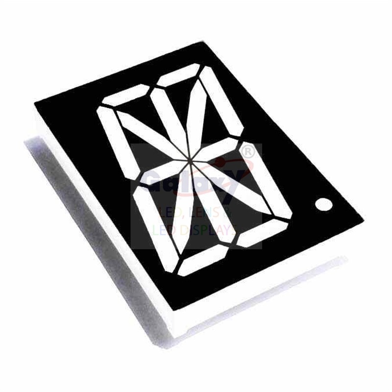

4 digit, 14 segment alphanumeric displays based on the HT16K33 driver are available. It certainly makes text easier to represent.
Thank You Sir, will try
Sir,
Toady I got Alphanumeric Display which display All character,if possible help me to show character on display instead of 1,2,3.... or
Sure. You have exactly what you pictured? How do you want to drive the module? I have boards with 4 of those, driven by an HT16K33 IC. Looks like this:
There is no functional difference between that display and a 7 segment. The only difference is the number of segments.
I hope when you bought it, you found schematics or pinouts first.
Sir,
Code provided by Mr. gcjr is perfect.Only issue is when we push the button to Select TC, it displays number 1,2,3 & so on ....Number 3 =K its very clear from code.In long term difficult to remember the number.It would be better to Display J,K,B,R,S,T instead of their number on First Alphanumeric Display.Kindly help to change in code.

are you trying to display an alphanumeric on the new display you got?

Yes Sir, First One display is Alphanumeric type and rest of 3 is ordinary display
i don't see any code to display an alphanumeric value on an alphanumeric display.
i don't know if the display can be given an alphanumeric value such as 'A" and knows which segments to light or if you need to have code to determine which segments to light.
a 7-segment display has at least 7 inputs, one for each segment and a common. it isn't given a value, such as 6 and know which segments to light

Here are alpha fonts for 7 segments:

7 Segment code is not a problem , Only would like to display char = {'B', 'E', 'J', 'K' , 'N' , 'R' , 'S' , 'T' };
with Mr. gcjr code.
