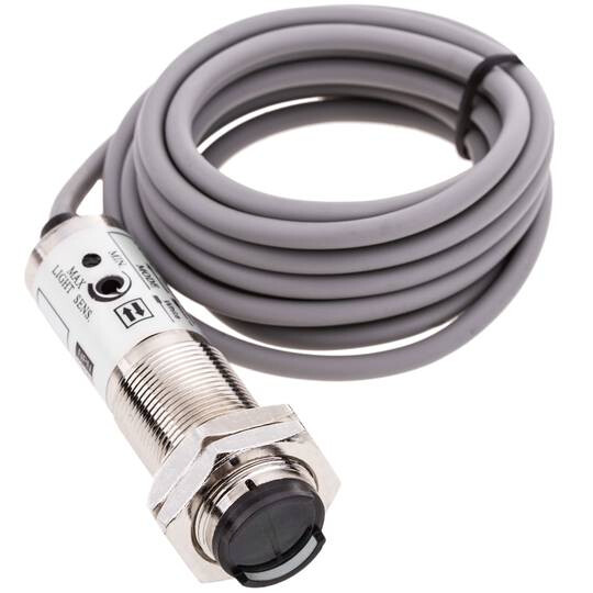

i wanna use this cellule photoélectrique not the one in the tutorial
Laser Photoelectric MEENJET GL-S18NO
How many wires does the part have? Which colours? If you bought it online, can you give a link to the page? Does the label say either "NPN" or "PNP"?

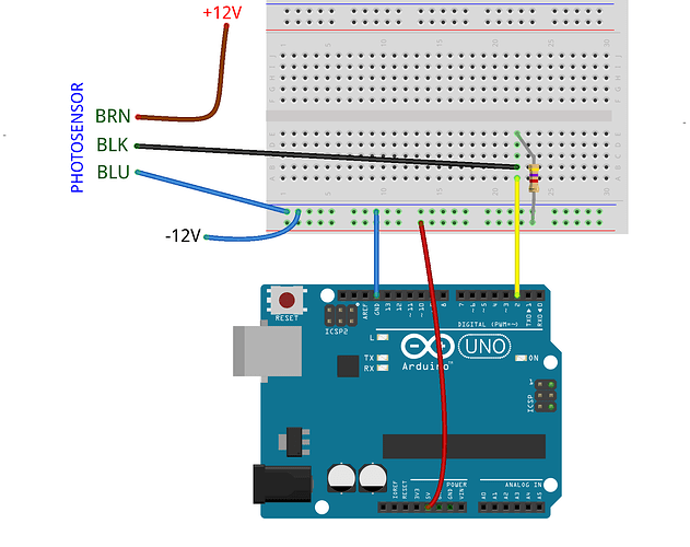

Connect it like this;
what about the code how can i replace it
Does your current code work with the push button switch?
yes
Then there is no need to change the code.
ok i will try it and thank you
