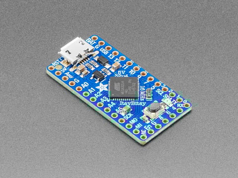

I am working on a joystick controller project, using this joystick library:
> **[GitHub - MHeironimus/ArduinoJoystickLibrary: An Arduino library that adds one or more joysticks...](https://github.com/MHeironimus/ArduinoJoystickLibrary)**
> An Arduino library that adds one or more joysticks to the list of HID devices an Arduino Leonardo or Arduino Micro can support.
I have it working on an Arduino Micro (ATmega32u4 CPU) per the above. I'd prefer to use an Arduino which comes equipped with USB-C rather than USB micro. So far as I can tell, there are devices equipped with USB-C, but it's not clear if the joystick library supports them. Can anyone help me navigate this?

I would say the connector shape does not matter as long as you have an ATmega32u4 on board.
there are boards out there for example
> **[SparkFun Qwiic Pro Micro - USB-C (ATmega32U4)](https://www.sparkfun.com/sparkfun-qwiic-pro-micro-usb-c-atmega32u4.html)**
> The SparkFun Qwiic Pro Micro adds a reset button, Qwiic connector, USB-C, and castellated pads to the miniaturized Arduino board!
> **[Adafruit ItsyBitsy 32u4 - 5V 16MHz](https://www.adafruit.com/product/3677?srsltid=AfmBOor9iXSgfFczhZ1BjAjU9tsIfK_sMC4xWGuWB_GcEgxdZDlyqPpc)**
> What's smaller than a Feather but larger than a Trinket? It's an ItsyBitsy! Small, powerful, Arduino-compatible - this microcontroller board is perfect when you want something very ...

Interesting. I don't need a super-small board and would prefer something I can through-hole mount on a PCB, old-school. I would have thought there was a lot more to it than mere connector shape between USB-C and its predecessors which would have implications for the controller, or am I missing something?

The cards @J-M-L mentioned are basically the same size of the pro-micro. So I don't get what your point is... 🤔

you can do that with both. just add headers.

Hard to tell from the pics... I thought they might be smaller than standard DIP pitch, which is already at the limit of my dexterity to solder.

They are breadboard friendly. If you look at details like their tutorials you’ll see more info.
The first one is castellated - meaning you can solder it on a PCB without having to deal with through hole headers. And it stays very flush and low.
