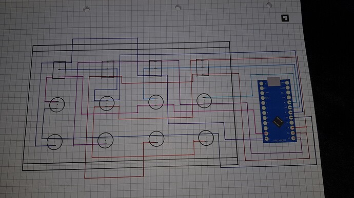

I have a picture attached.
It shows how I wired everything up.
